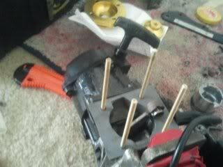

  • darthbeast1983
    November 6, 2011 at 9:28 am
    so i got all my stuff yesterday except for my spark plug. got the engine assembled and i must say it looks scary fast...especially with the fatty pipe on it. heres some pictures

  • darthbeast1983
