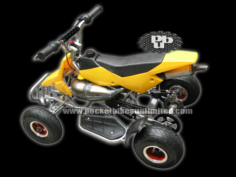

Hello All,
I received my first pocket bike today. Actually, it’s a pocket ATV. One of the mini quads or Quadard as referred to in the user manual.
I must admit, it was a purchase off the bay. I won auction a few weeks ago and found this site and sponsors selling AFTER. That said, I thought I would try to provide information so you can make comparison of my bike to the other offerings:
44mm big bore cylinder.
No third bearing support.
Stamped clutch bell, not cast.
Standard air filter.
Tires are street treaded 3.50 x 4.00 both front and rear.
Rims are two piece. Front fits tire well. Rear is about an inch wider. The tire is over inflated to fit.
Fuel line was too long and pinched completely off.
Fuel filter was installed in reverse direction.
Exhaust is standard Cag.
There was no shipping damage. The only writing on the box was "Velocita, Made in China". There are mini dirt bikes (Cag style) sold under that same name. The PATV uses the very same body, seat and frame from the dirt bike. The frame just has some other pieces added to it for adapting the four wheels. Overall, the welding is good. Even the front fender from the dirt bike appears to be cut in half and used as the two rear fenders on the PATV. The front faring is unique.
The throttle is pretty cheap (weak). The cable keeps popping loose from the track inside the black box portion mounted to the handlebars. I need to find a fix for that.
I had to center the handlebars and set the toe in. The tie rods really need to be about 15mm longer. There isn’t much thread engagement and I can see them breaking in the near future under some heavy loaded steering. The tie rod ends are the bronze spherical bushing type.
Accessories include the user manual, fuel mixing bottle, tool kit and a sheet of go-fast decals.
For size perspective, I am 6’0" and right about 200lbs.
Overall, I’m very happy with the purchase and it looks like it will be a lot of fun. I paid $258 including shipping.
A few questions for the masses:
  • Source for the wheels used on this bike?
  • I’m in Southeast Michigan. I read in the racing forums that some clubs are allowing PATV’s. Are there any plans for a racing class to include these?
Thanks in advance,

Great review, it's the first I've seen on a pocket ATV. I'm not sure about the wheels, but the tires are the same as Go-Ped Powerplay "TT" tires, and the same as the Razor Pocket Rocket PR200 tires, so I imagine if you need the rims you could go to Dave's Motors and buy some type of Go-Ped Bigfoot style rim.

Great review.
Do you know if a regular cag throttle will fit?
I received mine today from the same source for 270.00 shipped.
However the fairing was cracked during shipping.
Hopefully this will be taken care of in a timely manner.
I had a chance to ride one here locally and they really fly.
I already have a ADA 44mm headkit,ported carb,v-stack and filter for it.
PBU has a nice pipe for it but I'm going to see if my torker pipe will fit before dropping the 170.00 for the PBU Quad pipe.

http://www.pocketbikesunlimited.com/images/q4-side.jpg

Just looked at the black and red L7 on the PBU site. There is a close up shot of the front. Throttle looks the same as what is on the PQ. Is the cable jumping track a common issue? Any fixes?
Ouch on the damage. Hopefully it does get taken care of promptly. I was a bit leary of buying the method we did.
I agree, the PBU pipe looks like the best choice by far for this bike. Reminds me of the Factory Pipe brand pipes.
