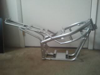

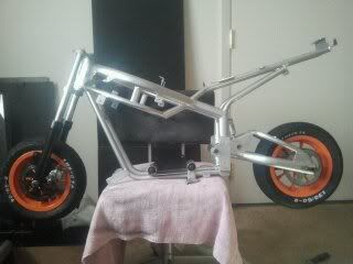

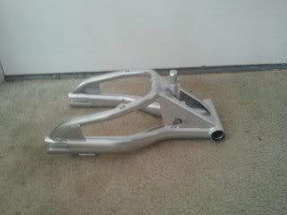

ok so i really havent worked on my X18 in a while but we will talk about that later. so when i moved to ohio i had 2 X7's one was a parts expiriment bike, the other just kinda sat there. it ran but i did a head chop and pretty much made a monster out of my yellow x7. so i was bored and completely disassembled the other x7. this is the build. please, ive already make a good 49cc motor. but im hoping cam2 or one of the other resident mad professors will chime in and tell me some more tips and tricks to unlocking even more power out of this thing.">">">">">

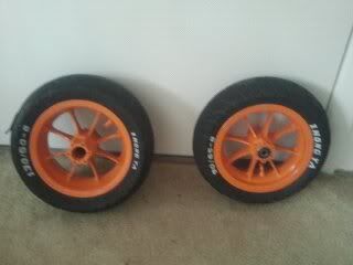

Sick build dude. did you paint the rims yourself? what tires are you running?

im running the stock tires i just colored in the letters with that white tire marker stuff. i prepped/painted everythimg myself, even did the head chop completely by hand
