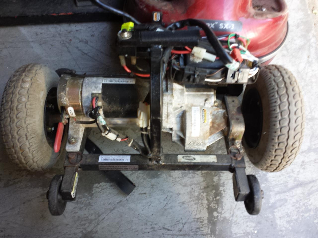

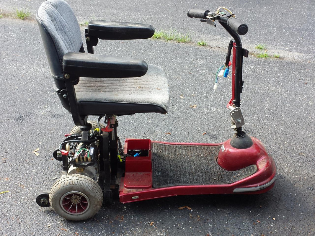

You're saving money...Thats true but now its got you in a problem much larger that might cost you just as much as buying the right rims needed for your miniquad..
https://www.monsterscooterparts.com/...1fd488e92f6f3b
Im pretty sure theres 15mm to 10mm reducers but theyre split tubes and like Kitty said the bearings will eventually give out on you causing another problem of finding a quality set of bearings that are perfectly sized for the hub and the 10mm spindles.......
Looks like you need to cut the 10mm spindles off and reweld some 15mm spindles
As far as the rear rim I see a way to use half of a front rim and making an aluminum adapter to fit inside the front rim hub inner half that gets held by set screws.
Another way would be to make some rimbhub adapters out of some 3/16" thick steel and welding them to the rear axle......
If not an option look up like Invacare and other brand invalid scooter wheels on ebay..
