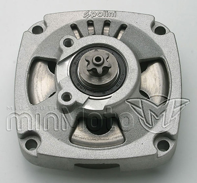

You have the wrong clutch housing because the old owner changed up on the engine....
This is the clutchbell with pinion pulley you need....
143.075.006 - Clutch housing complete kit includes clutch drum, bearing, water pump pulley & 6T pinion-standard 80mm/pinion driven water pump models
If you go with this clutch housing you will need to flip the waterpump and remount it 180* backwards and make some spacers to space the bracket off the clutchbell housing...…..
If the whole shebang is too much try getting a pinion pulley and modifying the housing with a grinder...…..143.115.003 - Water pump pulley on pinion / pinion driven water pump models
With that cob jobbery of a waterpump pulley Id say that engine is on borrowed time which would be from possible overheating....The guy should of atleast drilled in a rollpin n slotted the hole and drilled n tapped the pinion end for a screw with washer,

You can buy just the Polini pulley if you can find one and then JB Weld the pulley to the pinion gear. When you want to remove it, heat the pinion. Will cost $200 plus to buy a new clutch housing and then, will it line up with the water pump pulley?? On my clone 39cc Polini engine running a Polini clutch housing and Euro clutch, had to make my own bracket too. Remember that pulley is going to turn at 12,000 RPMs, so it has to be round not oblong, lol. See photo, that is not a drive belt, it a tank track off one of my kids toys. I put it there for the photo, lol.
I don't know where you buy your material, 200$ for a clutchhousing 🤔🤔.
A new pully 10-15€
A new clutchbell( don't need a new clutchhousing) 50€
The mounting material can be made be him self.
The big rpm is not the problem only must mount a biger pully on the waterpump.

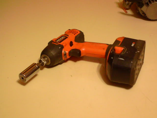

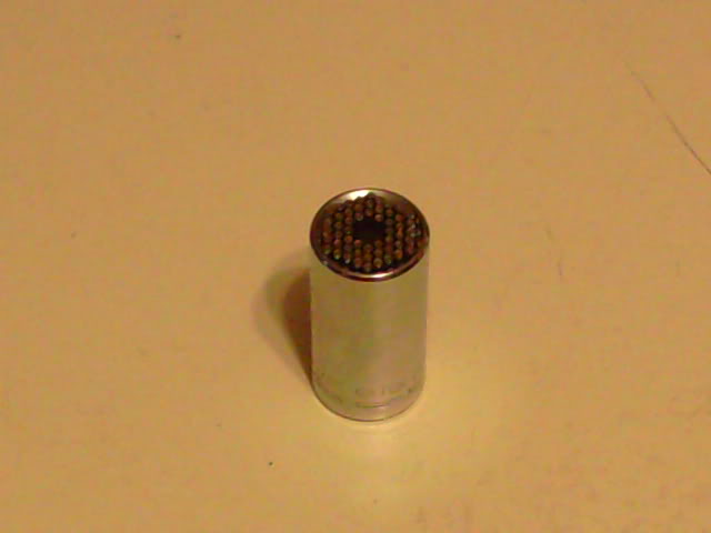

To remove the pinion I use a Gator socket tool on a 18v cordless impact gun with 3/8" adapter..
It removes them quick n easy...……..
