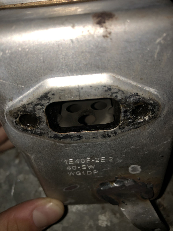

I did what you suggested and looked for any restrictions in the box muffler. I took it off and looked inside it and there was this weird plate with 3 holes in it instead of nothing. Do you suggest i make it so there is no plate restricting it?You also said you could show me how to debug the engine while getting a little bit of power out of it?
That plate with the 3 holes needs to be larger...……
Getting rid of the EPA carb and uncorking the exhaust is debugging it....
If the engine still is low on power chances are you have the restrictor plate between the cylinder base and the crankcase that needs to be removed also..

What do you mean uncork? The exhaust i have on this is just a simple metal shower fixture pipe, and for the plate do you mean the holes need to be larger or the plate itself? Thanks
Find a way to make that plate with 3 holes disappear...

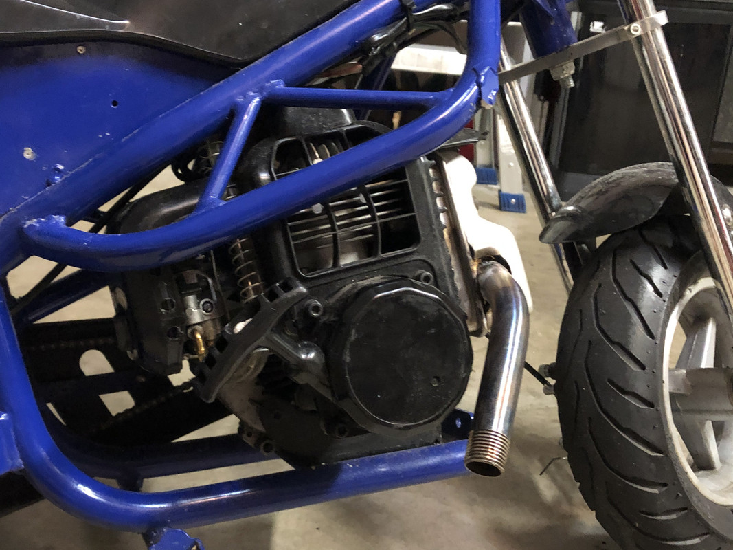

Holeyyyy crappp...I just realized from the wider picture angle you have a 40cc 4 stroke engine...Its not even 2 stroke...
The oil dipstick is behind the pullstarter……….
Get rid of that bike and get another...…….Those 4 stroker engines "Are the Worst"

The ad says its a 2 stroke but the bike pictured is 4 stroke so you better contact the seller first to be absolutely sure...

Dude thats literally the one i have except in blue.

Yes the new 2020 CAG is a 4 stroke you need to find a seller with new old stock even thow some sellers say it's the 2 stroke it's really the 4 stroke if you look at the picture send the seller a message before you buy... Looks like the EPA is clamping down even on the smallest of the 2 strokes they are no where to be found and when found marked out of stock...

Typ in pocket bike 2 stroke into eBay then look for an engine like this one
The piston port 2 stroke is to wide and the coil will hit the frame...

You see that black knobby looking thing behind the pullstarter handle...?
That's your oil dipstick....Pull it and see how much engine oil you have....
2 strokers don't have an oil dipstick anywhere

Its a four stroke piece of ........!!!! I like the style of the bike and frame, but there very short like 40". Unless you have a welder and enough tools putting a Cag 2 stroke in that bike, if possible would be a lot of trouble. I think someone else here already tried.
