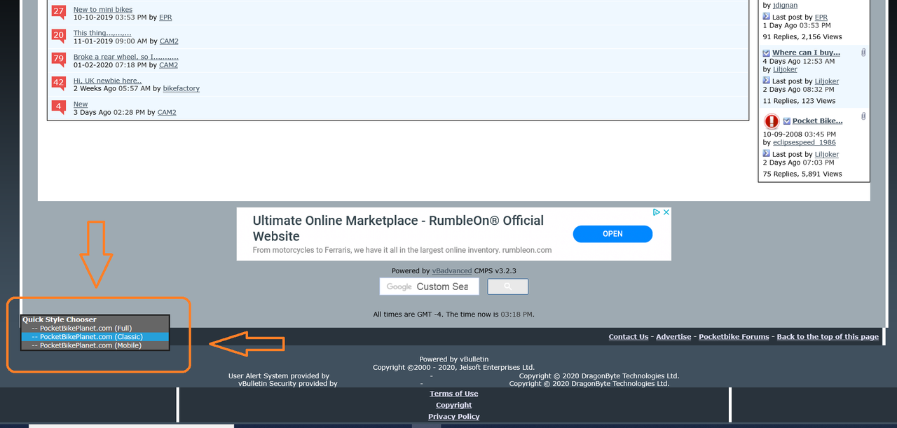

"Classic mode" is the oldest and best format to navigate this site with,,,,It has a blue screen and selected at the bottom of the screen on the lower left-hand side as in the illustration below..

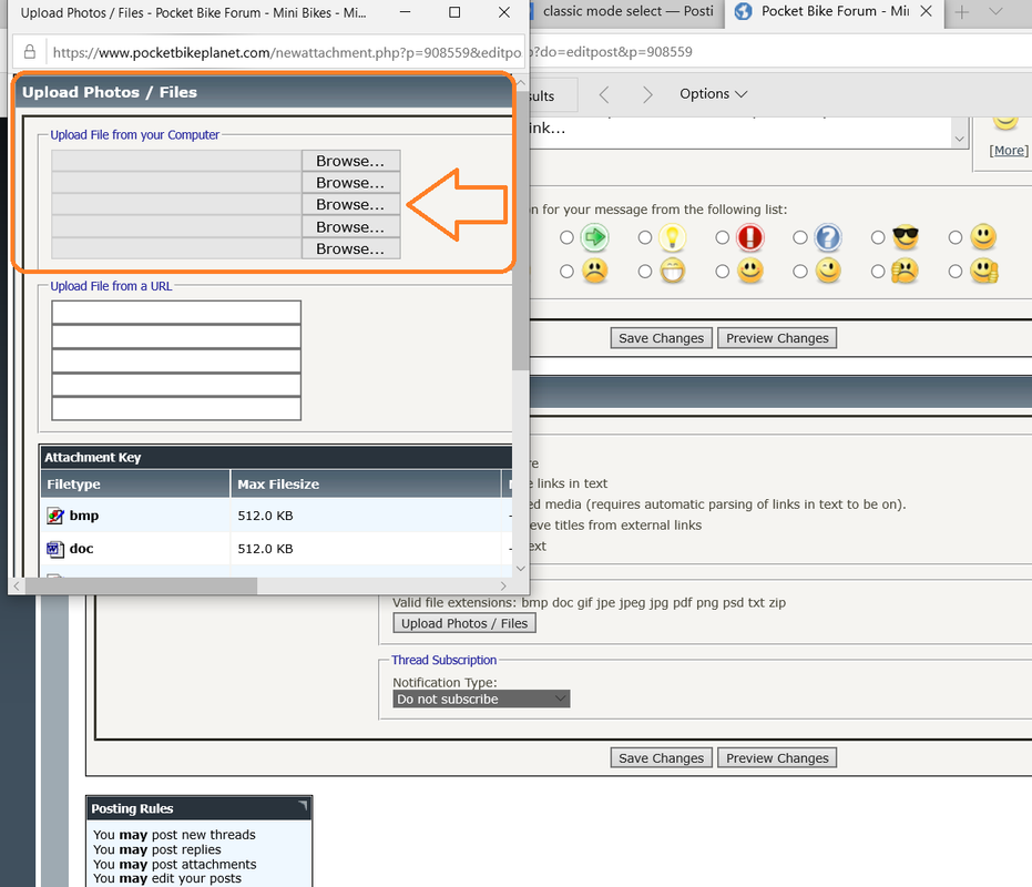

Posts: 21,575
Re: 2007 Italian made Chinese Cag/Hack full restoration

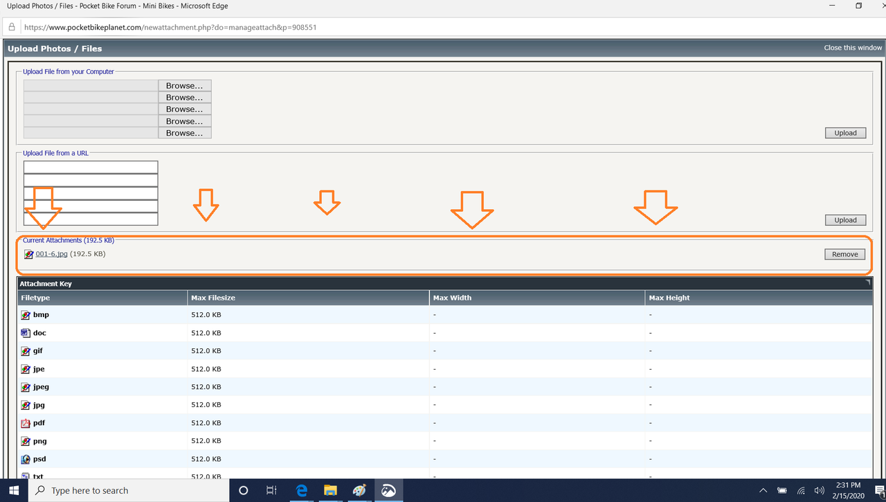

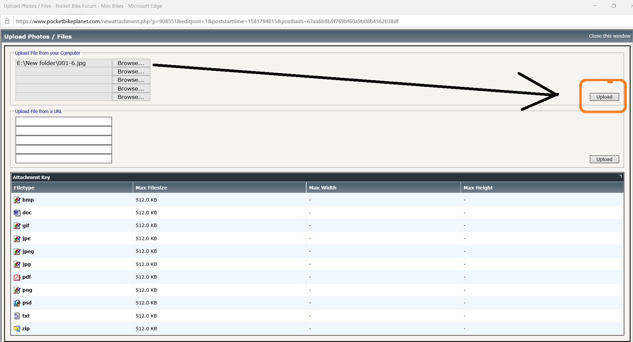

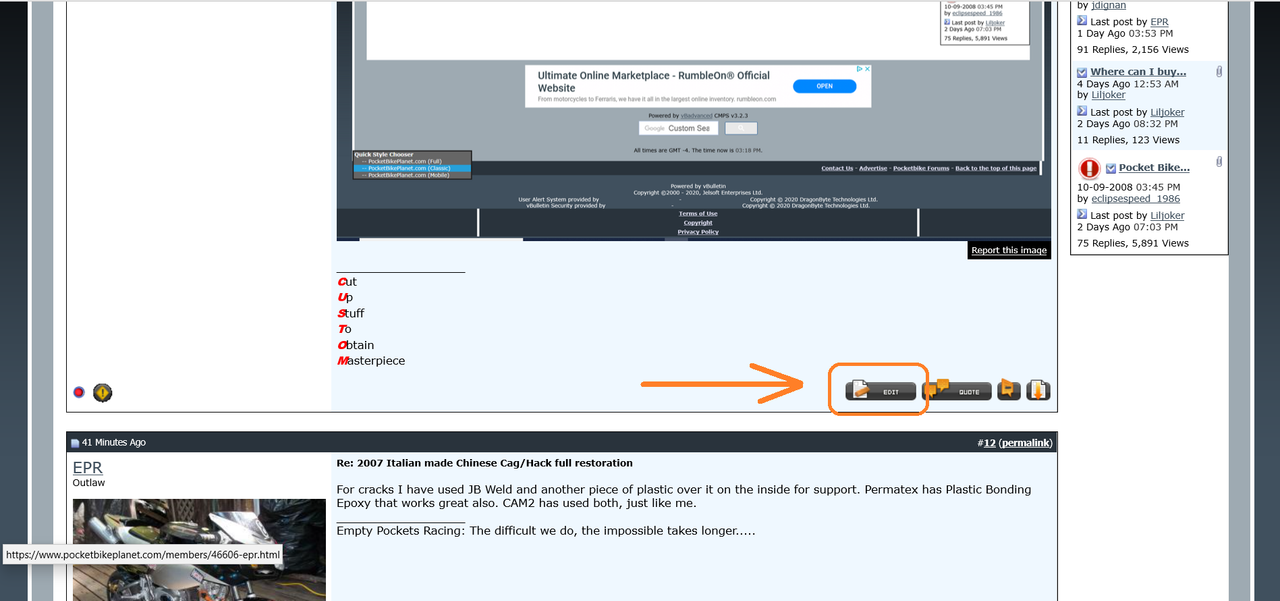

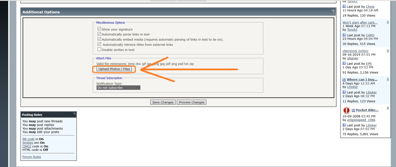

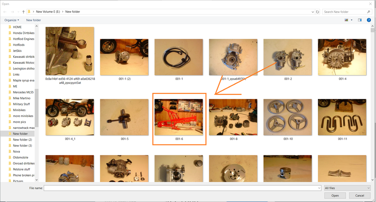

To post through the site you must follow the steps...This site has a lot...LOL
First step is to hit click THE "edit" button AS PR PIC...On new posts its called "GO Advanced"
Second step is to click "UPLOAD PHOTOS"
Third step youll get a "Picture Uploader" with 5 uploaders click one at a time to load 5 individual pictures..
Fourth step is to "Select a Picture"..
Coneejo13 likes this.
Posts: 21,575

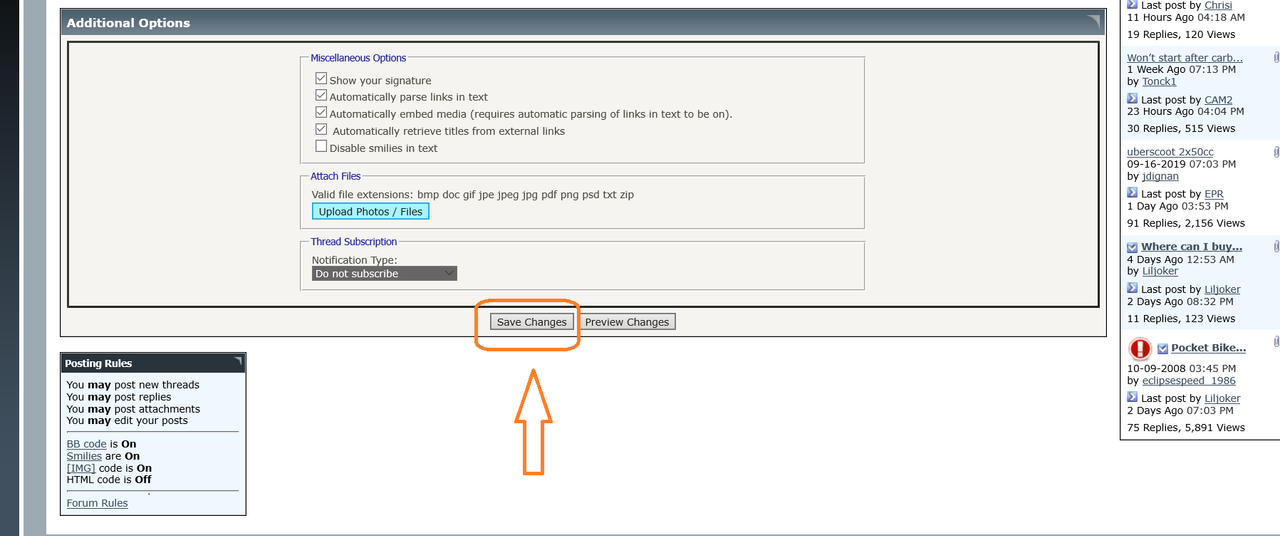

5th step is to maximize the uploader and click "UPLOAD"
6th step youll see it "qued up" in the uploader under " Current Attachments"..
7th step is to click "Save Changes or "Submit Reply".....
After you hit the "Save Changes" button your picture or pictures will appear like the picture of the cag frame I added strength and a lil extra stretch to...…..

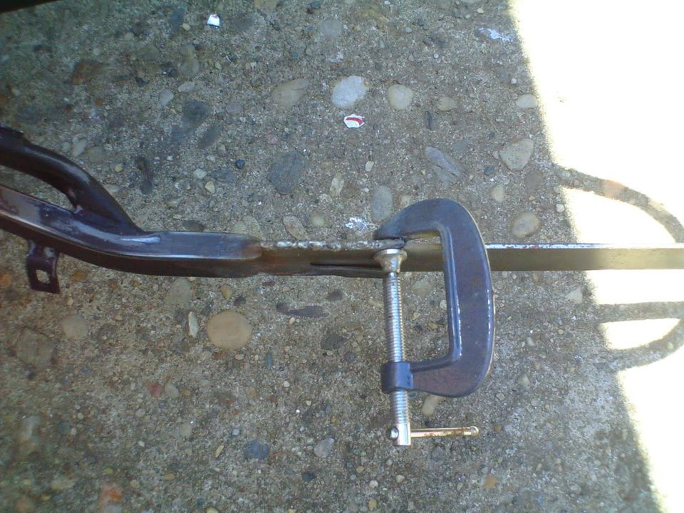

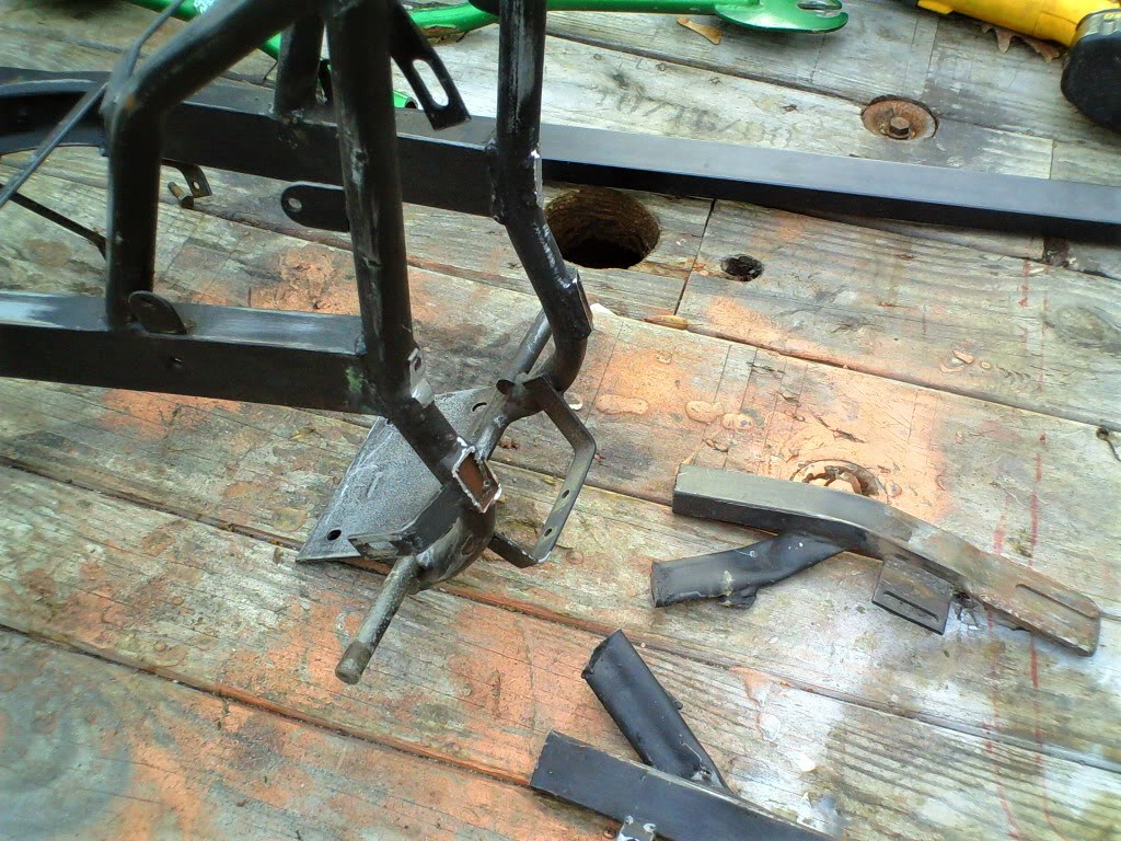

Heres a picture to show you how fast and deep the rust goes and can get...
The Cag frame being modified by me was kept in a shed for 5 years and never saw water like as being washed or rained on...It just sat through the seasons untouched until they decided to move out of NY and didn't want to take the rusty looking thing with them...I scored it for $20 bux as a whole...
I tried to salvage the rear swingarms but there was too much rust inside the rear arms to salvage them so I cut them off and grafted on some chromoly swingarms from a kids 20" BMX bike.....
Heres a shot of the frame of a brand new 1 month old cag I obtained in a contest..Never saw rain and was stored in a garage before I got it too.……..
The frames on the 2011's to date are ridiculously thin compared from 2003-2010...…….

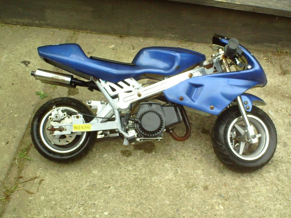

If I had a Cag sidecar racer I definitely wouldn't want to keep it stock.....
The idea is its a "Race Machine" therefore it should have some HP parts aswell as racer additions like professional style handholds for the sidecar passenger too...
For better friction rolling resistance you need to use the best quality wheel bearings aswell as clutch housing bearings to get the smoothest roll....
Sidecar racers have evolved so much that now the minis are running wider racekart tires to enhance footprint to enhance full throttling in the turns ability...………….
Id modify the tool based 1.6hp engine into a real racing engine with 5-6hp and take pics to document the process........
Originality in Chinese made stuff doesn't thrill most as run of the mill eye candy as the engines that power them are derived from brushcutters,trashpumps and power augers........They were never designed for motorbikes…….
To take the engine out of its tool based element it must be blueprinted and ported aswell as other parts modified to conform....

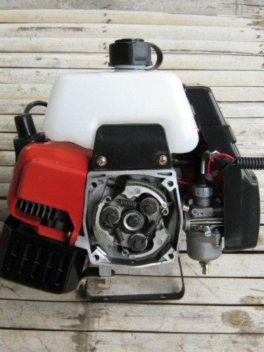

Heres what the engine on your sidecar racer looks like as a brushcutter engine...Its a copy of a Robin NB350/NB411

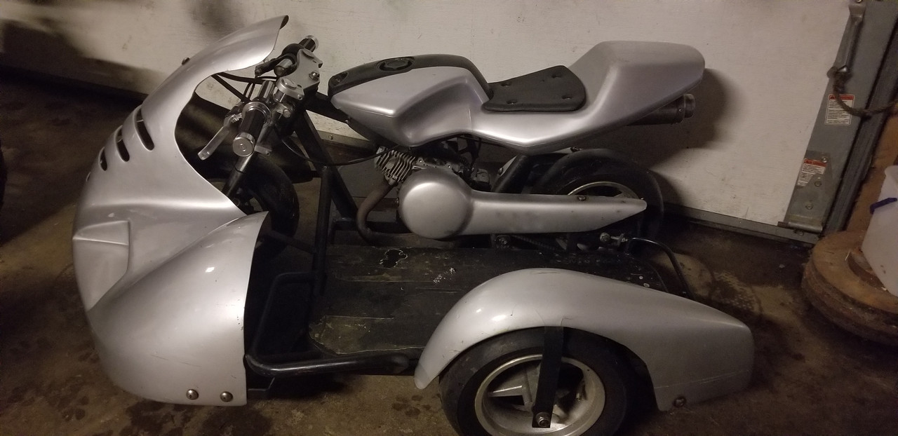

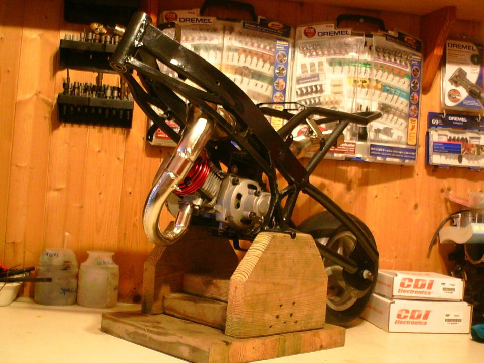

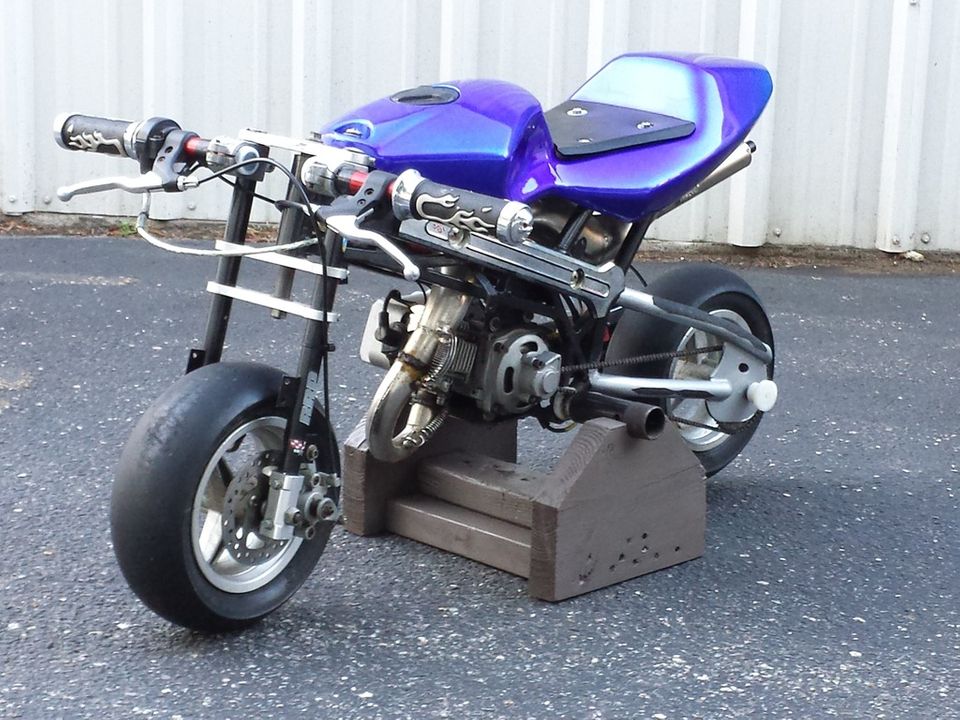

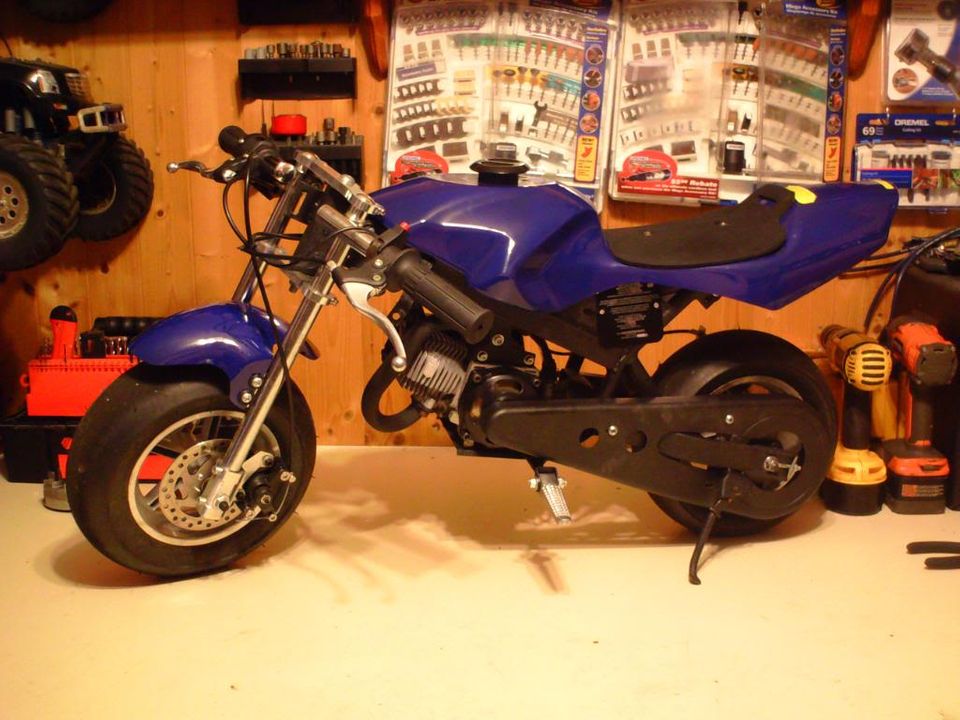

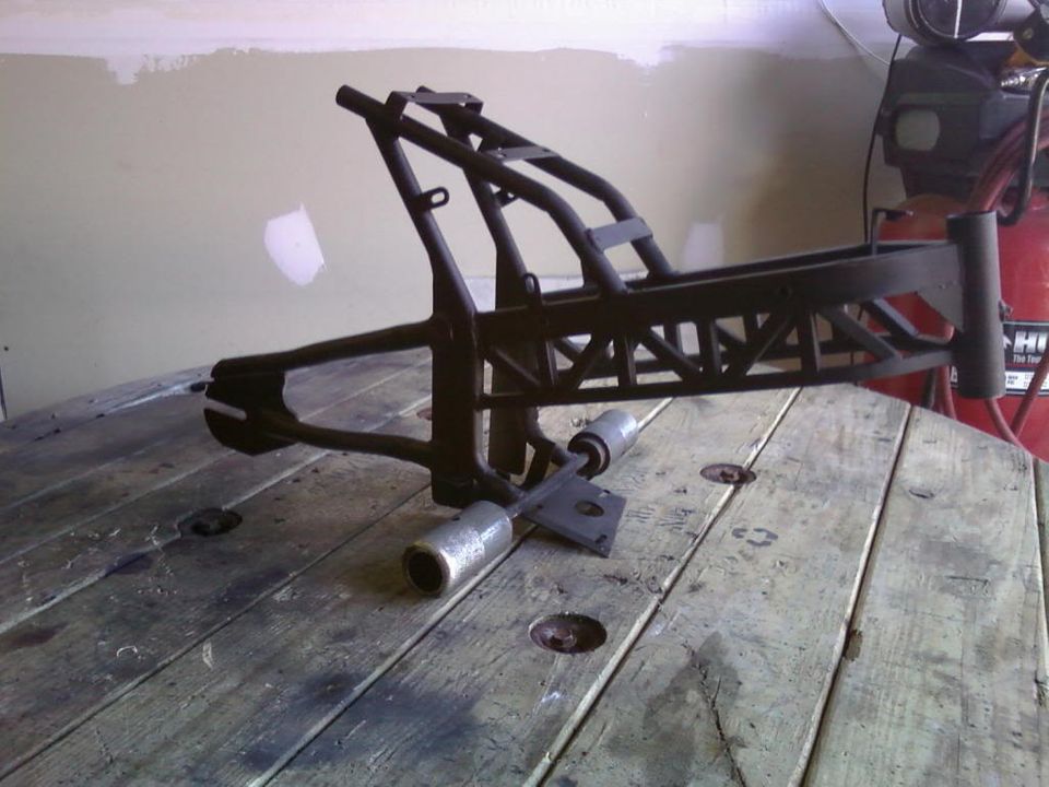

I began with the black assembled sidecar and got to powder coat these are the pictures here now. I have a steady progression of assembly I will be posting as I go, I have many more to post to catch up to my current progress. Future pictures coming.

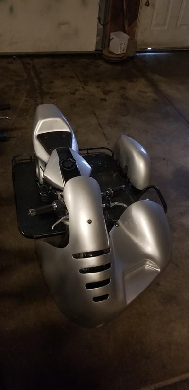

Ok, thanks to you all my pic uploading is working. I'm going to post them in order now up to current in the next few days. I have just completed repair, and paint of the third wheel cover and chain guard. I'm painting the seat/tank section now, I got ride of all the parting lines from the mold to make it show smooth and that is a challenge, so when I'm finished with that tomorrow I should be updated to the same day on my progress. I will comment as I go so the next 20+ pictures are since summer 2019 till now.
Thank you ALL for all the help and advice, I have perfected a way to fix all the plastics and only the complete fairing is left and it will take a month to perfect it.
