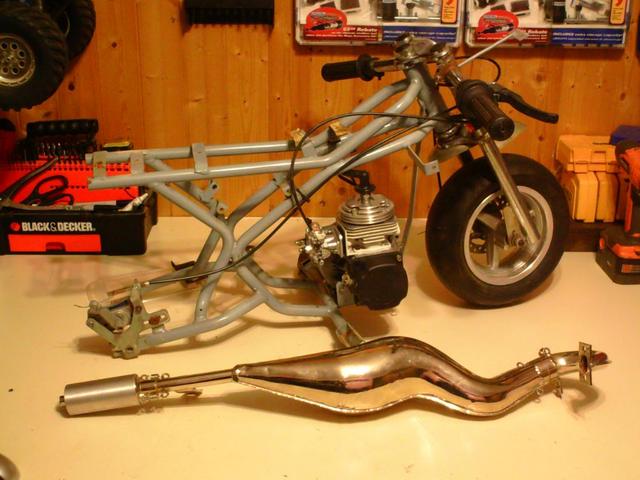

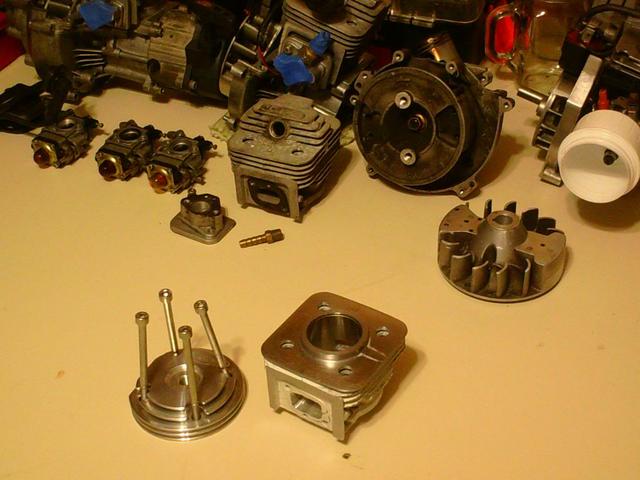

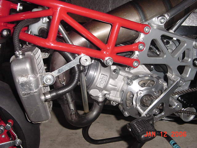

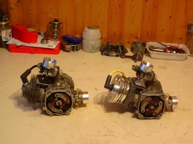

Heres a bone stock 2 stroke cag........
bone stock cag by Dizzy Gillespie, on Flickr
Heres a modified one..Tis one is a 2pc headkit with aggressive porting and blueprinting,lightening,balancing etc,,,
033 by Dizzy Gillespie, on Flickr
And another modified one.....This one is a 1pc stock cylinder engine with same magic I always do....LOL
trophy cag modded exhaust 2 by Dizzy Gillespie, on Flickr

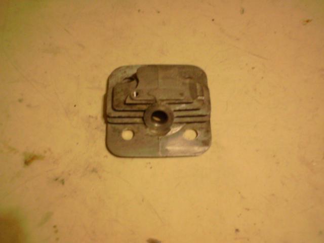

You carve out the bear grease from China trans, clean it good and put 100ml of light engine oil. Don't know why they call it a trans, it two gears, one three times bigger and a chain. Like CAM2 said its an RPM reducer 3 to 1.

You dont need a milling machine to shave off .010...Just some glass and some sandpaper......
I hardky ever use tools ither than handtools to work on these small engines....
On this 2 pc cylinder I did the handchop from 1pc to 2pc with just a simple handsaw a flat surface also a wetstone........

You dont need a milling machine to work on these small engines....Theyre simple..
I do all my work with handtools,,,,,,It helps to keep costs down...
I make my 1pc cylinder into 2pc cylinders with a hacksaw a flat surface with sandpaper and a wetstone..\
