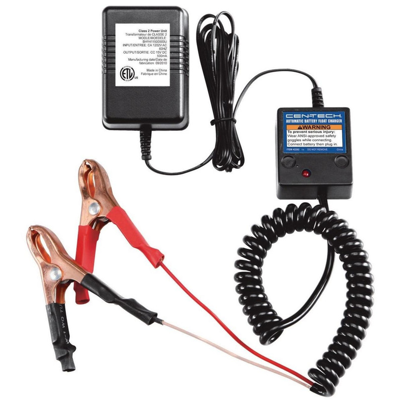

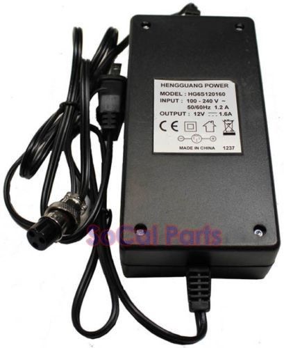

Actually everything with a battery really needs to be stored on a storage charger to keep the battery topped off but who do you know would go through the hassel?.....Apparently not the person who you got your bike from if they didn't supply the charger that comes with those bikes which is crap anyways...Heres what they look like...
Its better to use those cheapie $10 trickle chargers from Harbor Freight.
Switching over to LED lighting will further reduce the voltage draw.
