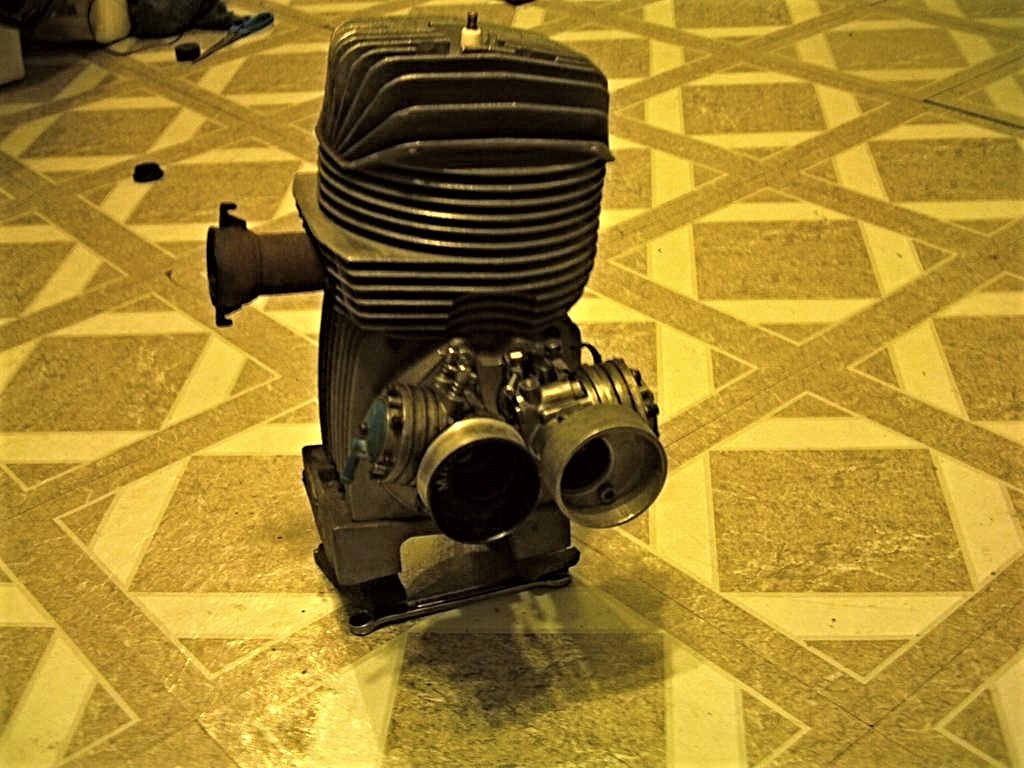

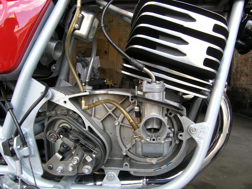

See this engine......?
Its neither reed inducted or piston ported...Its a 50 year old IAME Italian made engine that back then was pumping 52hp on alky/methanol mix and propels me on my racekart to 130mph..
If you look at its design and hearing the specs you might be saying that things got the best iof the best in it ,,FCC,fully balanced engine etc.....
That could be further from the deal as you can see the carbs kinda feed the engine sideways directly into the crankshaft...A crankshaft thats not FCC but still spins well over 20k rpm's...
What controls the action is a highly precision set plate mounted to the crank right behind the intake manifold that rotates and precisely feeds fuel and also creates velocity while the crank simply slaps the mix into the cylinder as it kind of creates a suction demand that when it opens sounds like someone breaking the surface of the water in an attempt to take a gulp of air in a hurriedly way before they pass out..........Essentially it is kinda like a reed inducted engine except theres ZERO reed float.....
Very very unlike a euro designed IAME engine that they put on PB's that utilized a fcc, reed valves and high compression to create the velocity needed to produce the power they make....The kart engine has a compression ratio a tad lower at 15:1 but thats because its run on methanol/alky not high octane pump gas........
Had they adapted to the older vintage IAME sidedraft intake design those euro bikes with that style engine would of been quite unstoppable IMHO..... ..
Heres another example...…..If you didn't know theyre called rotary valve two strokers…..

Love that rotary valve on last photo. The 10mm FC crank is 500g, pretty heavy for a high RPM engine. So, we could maybe build using a stock 47cc crank and 44mm x 10mm piston.in a 49cc cyld. The 3 new 40mm cylds I have, the OD base is almost the same size as the width of the case transfer ports ID. Would need a plate underneath the cyld tapered to fit the difference in the T/P widths. I have a Sarren 2 49cc one piece stock cyld I cut the top off, its T/P width ID is 56mm and the case ID width of 61mm without a case gasket, that leaves a shelf of .080" on each side blocking the case ports, Think that's a no,no. All 4 of the 49cc 2 pcs new cylds I have has fingers and one upper port, has a 65mm base OD and about 57mm to the widest part of its Transfer Ports, which will need to be hogged out to a 61mm width that leaves about .060" on each side for the cyld base to seal on the cases. Unless you have a 40mm cyld with the base of 65mm don't think the 40mm will work with these cases.

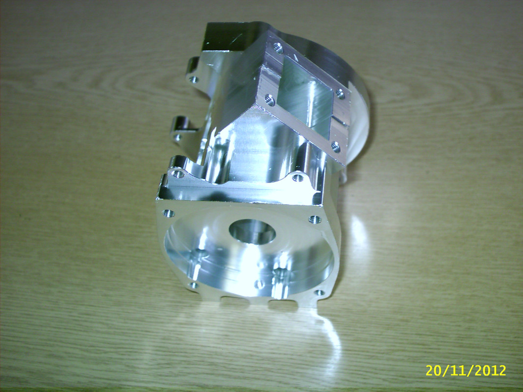

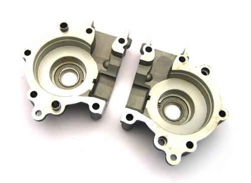

Kind of like how these Polini AV-10 cases are profiled.....Look at how flat the outer wall is and how thick the bearing area is...When assembled the bearings in this case sit 1.6mm's raised above the case not flush or countersunk...This eliminates the need for spacers and not having the crank hit the case...….
Also note how short the reed intake area is.....I'm thinking about removing 10-12mm's off the reed entrance area then redrilling and retapping the holes to get more suction and reduce volume...…
Also notice how wide the jug area is on both AV-10 Polini casehalves.

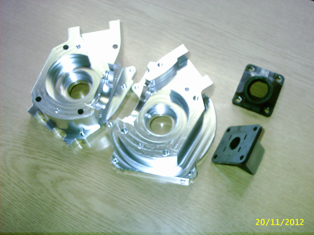

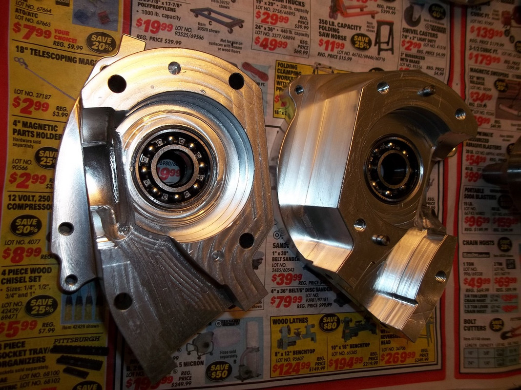

This is some pics from driverD's thread
If you milled both casehalves so the cylinder bolt holes actually lined up with the cag cylinder like driverd claims would be able to happen in his sales pitch thread the casehalves would have a space of about .100"...maybe larger with the crank installed inside.......
If you look inside the casehalves of how deep the bearings are...Theyre not too deep like you think....Its kind of the opposite
Not enough case material was removed on the bearing sides of the jug area by driverd's mill to properly accommodate the crank and not enough material was removed at the mating faces to accommodate the cag cylinder...
All in all in my end result of seeing aswell as understandng the whole situation the billet case driverD sold you wasnt properly finished in every area to proper dimensions or not properly programmed to be cut right........

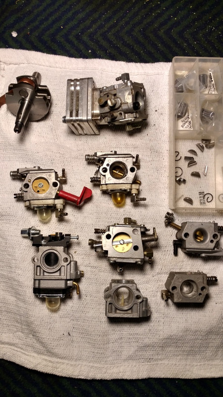

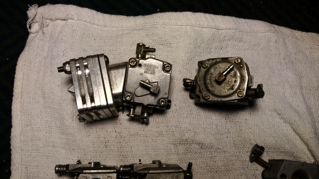

I also have a new 19mm HDA223B pumper carb, could not get it to pump gas, but have a Walbro repair kit for it. I have never had a pumper carb apart to many small parts for me. Looking for a way to mount it to the 19mm universal Polini rubber intake manifold. I have a few Tillotson style 25mm pumper carbs with the big round rubber diaphragm type, for bigger 2 stroke engines. My pick would be the 19mm HDA223B, have alum intake & V-stack I modified from 16 to 19mm x 44mm to fit the carb. Here are some photos.
The HDA223 should work out perfectly..

Going to get the 223 carb and manifold and parts I made for it and look at the mounting bolt spacing on the cases, to find the best way to match them up. Still gathering stuff for the project.

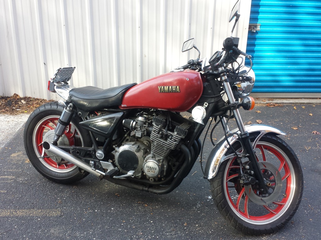

Took the 83 Yammmie Bobber out today to give it a good run and when I went to give it the onion from a ead stop 2nd gear gave up the ghost..Good thing it happened right when I started grabbing for the clutch as it has no rev limiter...............
Now I have another engine teardown project on my plate....LOL
Im thinking about going a lil farther with it now and mod it similar to the engine on the 89 CBR600 with a fuel injection, VVT mod and methanol tune.....
It should really turn heads when finished.....LOL

Ok, found the HDA223 in my C1 containers. I got the carb from SD Scooters, he said it did not work. What I have here will bolt to the billet case intake. I took a broken 14mm C1 rubber intake, ripped the alum tube out, ground the rubber down till it was flat. Then put 2 holes on the edge to match the carbs 2 top bolt holes with counter sunk bolts on the back side. the bottom carb bolts also hold the bottom of the intake to the cases. I tried to run it on the C1 but it did not pump gas. You know that its a purge carb, I put a purge fitting in the C1 cases near the reed block. We can do the same thing on the billet cases.
Here is a 25mm carb, 4 stroke carb adapter and tube I made to fit a 19mm Polini style intake manifold. The pulse hole is inside the manifold.
That HDA223 carb will do the job.. Sometimes they put the wrong spring under the fuel needle or don't put the right fuel needle pivot too.....
Either way if the carb body is good I can get it to work...I have plenty of stuff myself too so one way or another it's gonna get accomplished.....
