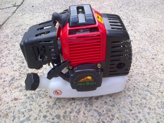

Where can I find whole new engine for the x1 pocket bike. Can't find one anywhere
You just have to use good keywords......………Only thing is finding one with an X1 trans so I hope one isn't needed.....I just saw that a complete engine is needed..Not engine and trans..

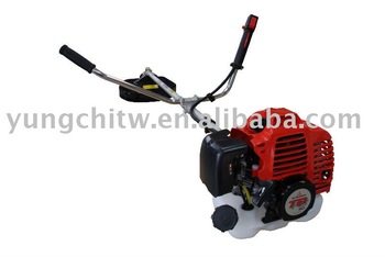

i think people run in to trouble searching for parts because they try to use the randomly generated batch codes stamped on the frames and engines.
post #77 of 83 (permalink) Old 12-30-2019 Thread Starter
Posts: 21,620
Re: Have A 2 Stroke A/C Pocketbike & Want To Make It Faster?????....Look Here If You
Pretty much and probably the keywords used to do the search....
Most think the engines are model specific like a Chevy having a Chevy engine..
They don't realize the engines are put into many different types of rideables..
The eye opener is when they find out the engine mounted in that X1 comes from Augers , Trashpumps and Backpack blowers with e-start and Brushcutters…….LOL
