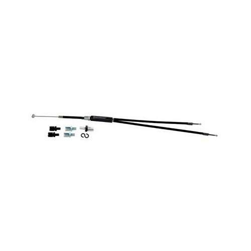

Dual throttle cable solution
Sprocket spaced off disc rotor.
And mocking up for overall look?

Originally Posted by Kimjon View Post
Attachment 149165
Attachment 149167
Attachment 149169
Looks pretty slick Kimjon.......I use one of these for my twin enginned builds by swapping the top cable for a cag cable.........
