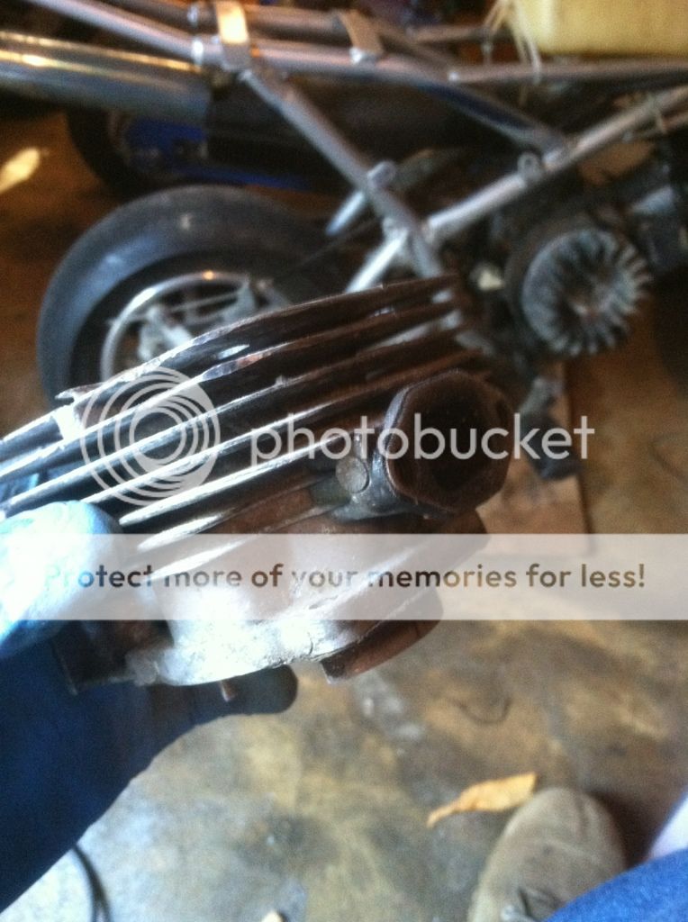

I just started working my 49cc Piston Port engine build today. I cut the top off the head so i can run a big bore top on it. Heres what i have got so far. Also wanted to make sure im doing it the correct way. I also started working on porting the intake and exhaust ports. Pic 1(Before i started)

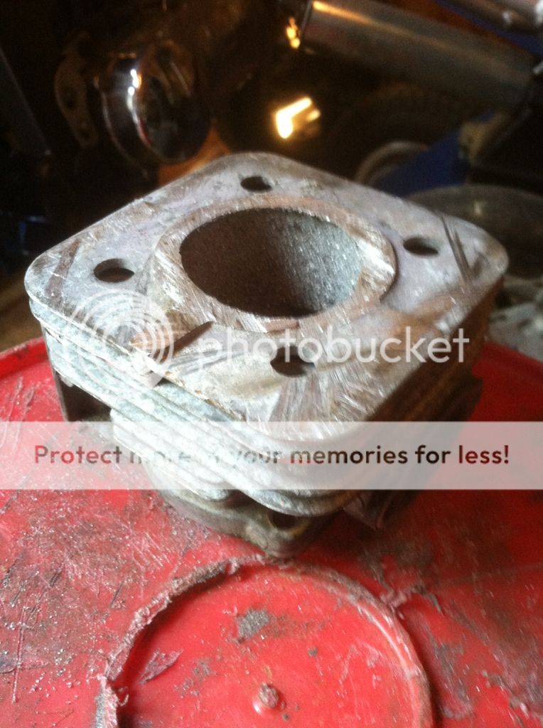

Pic 2(Just finished cutting the top off)

How does it look so far?

The top isnt flat yet. I hope im doing it right. Haha
it looks to be ok so far...looks like you went off track while making the cut a lil but it should be fine and if Im not mistaken looks like it maybe a 43cc cylinder
youre gonna need a 2 1/8" hole saw to remove the fin needed to make clearance then youre gonna have to beltsand the lip and the side of the cylinder to size....

Do i sand the the top flat first then use a hole saw to remove the fin?
First etch the path of the cut against whats sticking up right now using the holesaw so you dont lose your way...
after you get that defined trench beltsand it flat then remove the fin...Youll have to cut away at the aluminum chunks thats casted into the fins to get the fin removed in 1pc.........
