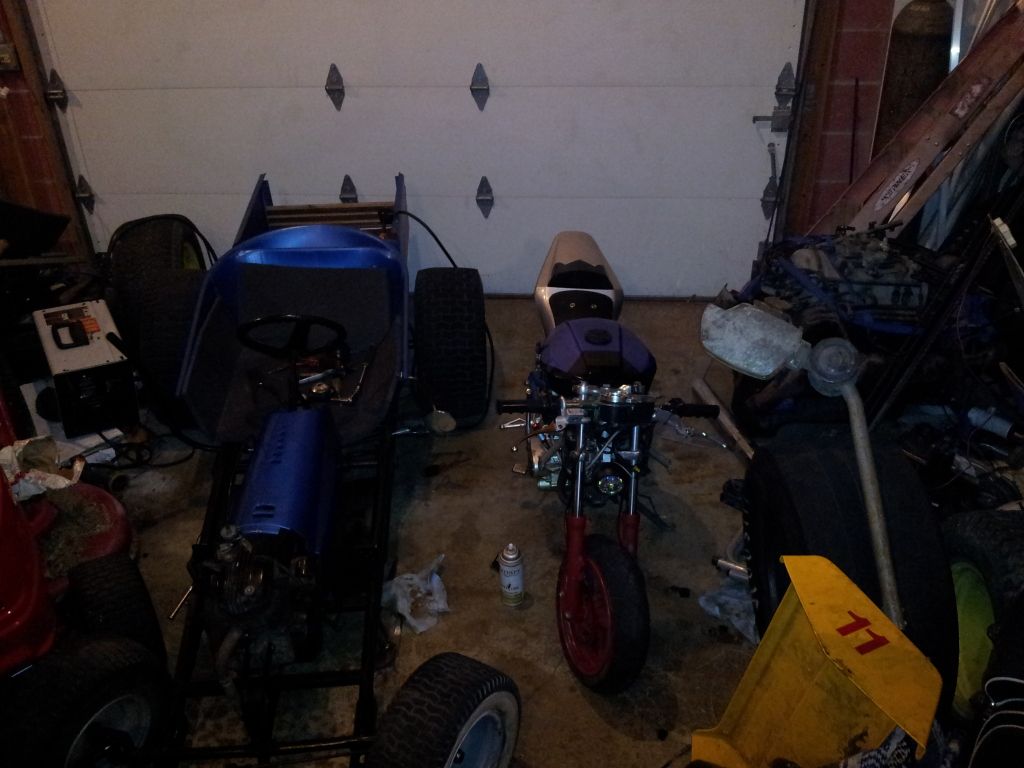

and, for a treat, a shot next to a few of my other projects...LOL on the left we have my 75cc honda 5 spd powered gocart, and on the right, the engine i am building for major boost for my truck....and the slicks for the truck for the track..LOL

wait till you see the diference in the motor sizes, the 160 is so fat and wide
