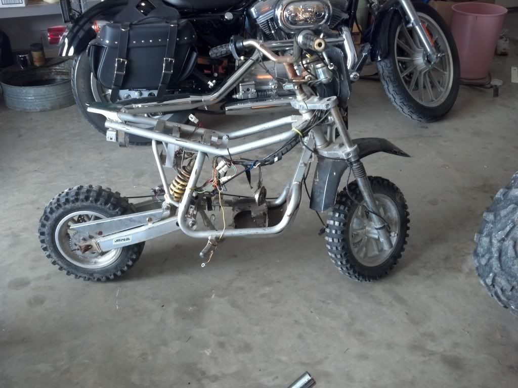

Dr9 aka Monkey bike, needs plenty of work since this is the condition I picked it up in

Nice...all 3 bikes you have are Mitsubishi clone piston ported engines...the cateye is gonna be 49cc as was the dirtbike and X9....
All 3 engines are the same ..............The dirtbike is also gonna need a transmission so a whole cateye setup may work no problems.........

I am a little short on working engines right now, I have a bid on a tranny on ebay for the monkey bike and wiring I figured if I needed to I could order one for a cateye and that should work. I can find all of the monkey bike body except for the seat on ebay, kinda pricey though. Have not been able to find body parts for the x9 yet.
