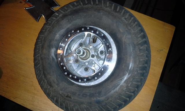

Do you guys think this would work for a back tire and rim to replace the dually on the apc mini chopper?
No....you would be better off buying a set of 6.5" cag wheels or atleast the rear.......
The rim you have pictured is the same exact width as a single rear wheel from your current setup.The rear would look like you just removed the rear tire on the left and will need to put like a 5" spacer on the left side so you can hook the chain up properly . ...
The rear rim needs to be something like 8 - 9" from sprocket to brake hub.....
