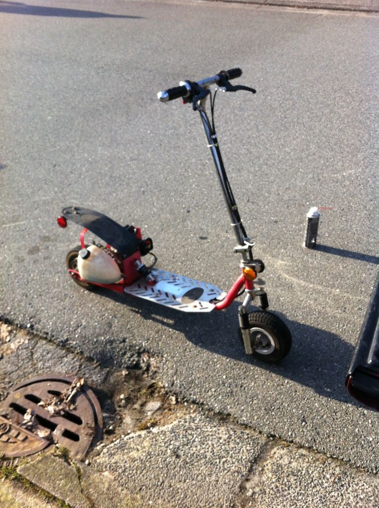

My dad came home with it, he got it for free. Its got the red cover so I believe thats the 39cc? The engine was seized. At first I thought it was the piston froze in the cylinder, but it was the crank stuck in the case. No oxidation, just froze up. A WD40 bath solved that. I got it running, at first it wouldnt rev, just bog down. After playing with the carb it revs, but if it idles down too low you cant save it and she dies. Can anyone ID this for me? Im pretty sure its a goped but idk for sure. If it helps the exhaust is nothing special, just the muffler box and a little peice of pipe, like 1/2 an inch long

Its a 33cc Zooma Scooter...........I have one of those....Its pretty modified and pretty fast for being 33cc too.....
The symptom you stated is indicadent of needing a possible carb cleaning of the fuel strainer,,in-tank fuel clunker/filter or the carb could need a rebuild kit nstalled.............
Its a pretty nice looking scooter compared to when I found mine......Good Luck with it......

Yea, I was thinking it was probably something partially plugged in the carb. I havent been bothered to take it apart yet. Another thing is the back tire is flat, and my fingers are too big to fit inside the little hole in the sprocket to unscrew the valve cap. What kind of mods have you done to yours? Plan is to get it going good, looking good, selling for a couple hundred and putting that towards the mini DB frame/47cc engine combo I have laying around

On mine I popped the head,,I basically blueprinted the bottomend lightly,,polished the crankcase bearings,,polished the piston and rodend ,,widened the transfer ports,,lightened the piston,,added a 15mm carb/intake manifold,,boost bottle,,homemade hp airstack,,stuffed crankcase,,indexed the piston,,installed head wothout the basegasket to bump compression,,rocket key,,lightened flywheel,,modified clutch and rev pipe...
Top speed in bone stock condition it was cruising at 17mph..After mods its hitting 28mph
They sell valvestem extenders so you can get an airchuck to fill the tires easier..My airchuck has a dual head which works in any area and type tire.....
