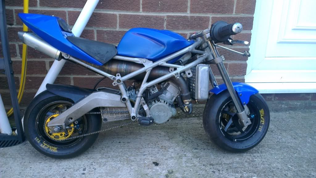

See my avatar Lucky 7 semi chopper, I had to make a side pipe, and put the foot pegs on the front axle. A Jet Pro and 7 other exhaust would not fit in the frame without major mods. I built it from parts and put C1 water cooled front forks. Best would be shorten your stock exh. headpipe 4" and add 4 or 5" of 2 1/2" to 2 7/8" truck exhaust extension to the middle of the bellyod it to fit your frame and weld your own pipe or take it to a muffler shop. Here is 2 I am working on and one I made for my 40cc Polini water cooled engine.

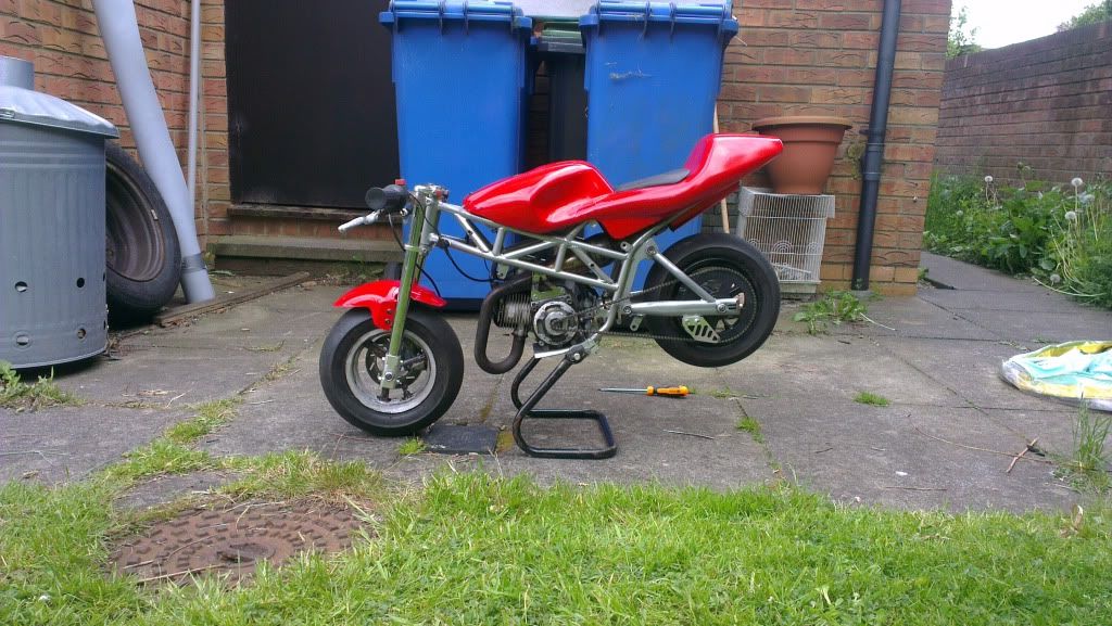

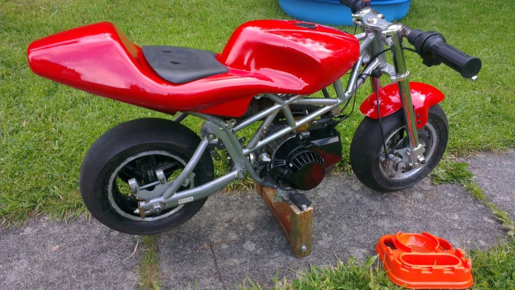

Well alot of the bike has changed after my horrendously long absence sorry guys but anyway i have done a bit to the bike i have painted the farings a deep red and have also found some new wheels out of my supplys because the old valves were leaking on the old wheels i have also installed a rocket key to advace the timing and also a exhaust of a baby blata tell me what you guys think.

Nice red paint, I hated that green. Should have got a red starter cover,lol. On a Lucky 7, better to mod your own exhaust. I tried 7 different pipes I have, none off the would fit in the narrow frame, I put a 5 port billet head hp engine I built in it w,front foot pegs and made an under pipe into a side pipe.
