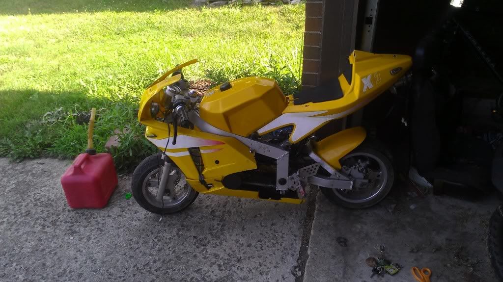

Here is a pic of my x2
I don't have a scale but i'll try to pick one up from walmart or something. what weight should they be? what do yours weigh? just so I have an idea of what are I should be in. That's a pic of my bike but I haven't figure out how to enlarge it here yet. I only been on this site for a few days so far lol. Thanks
CAGowner, what else would you suggest to do with it?
That looks nice! I like it
