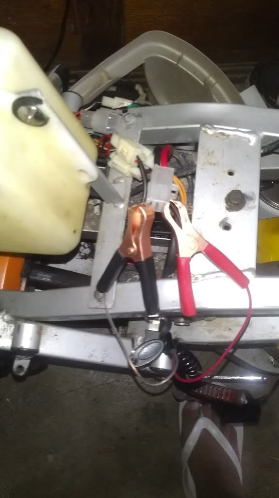

Ok so I recently bought a 12v float charger for my X2 PB and I thought there would be (+) and (-) prongs on top of the batterie and there's not just pos and neg wires ,should I strip my wires And connect the charger so it can charge??? Look at the pic below:

On my X18, I flattened 2 alum pop rivets at the end into a blade, stuck them into the plug and clamped on the ends sticking out. Small nails will work too.
I tried wires, nails,end of a notebook and some other random metals
Are you sure the charger is working?? And why do they call it a Float Charger, like something goes inside the battery. Better read the instructions and try to test it with a voltage meter, should read 13.7 volts.
It should, it's brand new maybe the outlet doesn't work I'll test it and re-read the directions
I found out, a float charger is only intended to MAINTAIN a batteries charge and NOT to charge

A float charger is a charger with two or three different capabilities and switches automatically between charging mode and storage charge mode............

I no I can't wait:) the float I have is only to KEEP the charge and it's not intended for charging
What amp rate does it charge at?? It might take 2 or 3 days to charge it with yours. Take it to a car parts place, don't tell them its new and ask them to load test your battery, they need to charge it up to load test it, so if it's a good battery you take it home charged.

If its 1.25 to 2 amp/hr rate charge a 6 amp battery should take from 3 to 5 hours.......My 12 amp battery for my X15 took me a whole day to trickle charge at 1.25 amps
