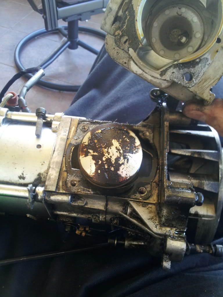

Alright so wanting to learn as much as possible about these things, and to get over being timid when it comes to modifications like this, i want to attempt to port my own cylinder.
I saw a post about which bits to get for the dremel, which i will pick up, and i also need a file set. Both of which i will invest in coming up, and i am in no way in a hurry with this project. When ripping the head off of my crank, the top of the piston has some build up of im assuming old gas/oil mixture. Extremely tough on there, but if i soak the tip of the piston in seafoam, id expect it to come off like nothing.

if you got it open it wont hurt to add 4 windows to the piston,,deburr the edges and raise the sideskirt profile a tad,,widen the intake and exhaust 1/8" on each side and reinstall without a basegasket to raise compression..

Thanks for your expertise cam. I wanna do all of that, and the windows to the pistons worries me the most. How would i do that 100% precisely?

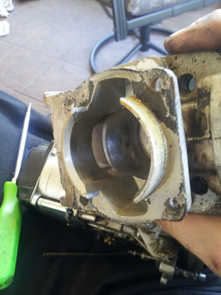

What do you go off of when adding windows to pistons? Try to match what yours usually look like yeah, but I don't wanna damage the integrity of the piston to a point where it send a piece of metal through the crank lol
You keep the windows inside the width of the transfer ports on the sides....If you put the 7/64" holes where I put mine then youll be ok,,,,any higher and youll be in the ring lands and any lower and youll be drilling through the beefy part of the pin journal which will slow flow and render the mod pretty well useless..When pistioned properly itll drill through perfectly in the right spot.............
See the two humps in the sideskirt under the pin on both sides...?..Those need to be grinded in aswell....
This is a 40mm 43cc piston
Both are drilled at an angle it seems? And these holes are the windows..? Seems aloeasier then the windows I'm imagining. Sorry for the confusion, perhaps I have more to read first
