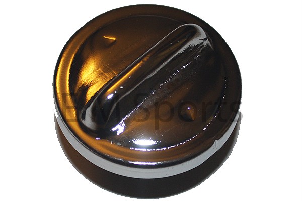

So I have the stock x18 fuel cap that looks like this:
Now when I ride at any speed, it vibrates VERY violently and shakes and makes a very annoying noise. I tried to tape the spout of the tank and it worked, but when I tried to put the gas tank cover back on it wouldn't fit. What should I do to stop this vibrating? Thanks!

I went and got a o ring to fit under the cap and mine has been fine no vibrating nothing all good
Alright thanks I will have to do that!
id try making a gasket on the cap out of foam or rubber, when i made a few gas caps out of pistons thats how i did it

drgnprelude, what size o-ring did you use? Thanks!
Don't know I work at a auto garage and I have plenty of them in all different sizes so I found one to fit and stop rattling and that was it take the cap with you to a auto parts store or home depot or Lowe's and find one to fit up where the cap sits on the kneck or rim of the tank
