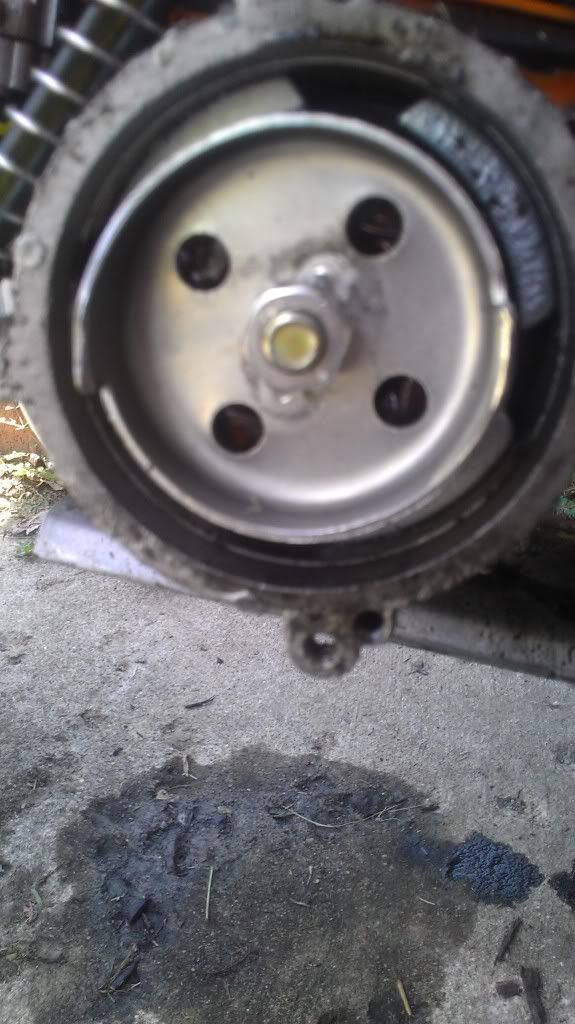

Yeah but I don't have a charger hey does this part need to come off?

no, just the pull start... take the center bolt out and check the spring underneath the roller. if its off, rewind it into the spindle, and rerwind the rope back onto the roller.
better clean up that gas spill before you stain your driveway.
Going as fast as I can lol.
It's oil and my mom doesn't care, I wind it clock wise or counter?
mine are all wound counterclockwise.... IDK about an Xbike, dont own one...
The spring isint your conventional spring btw, and watch your face when you take the center nut out, if it is dislodged from the spindle, it could whip out at your face.

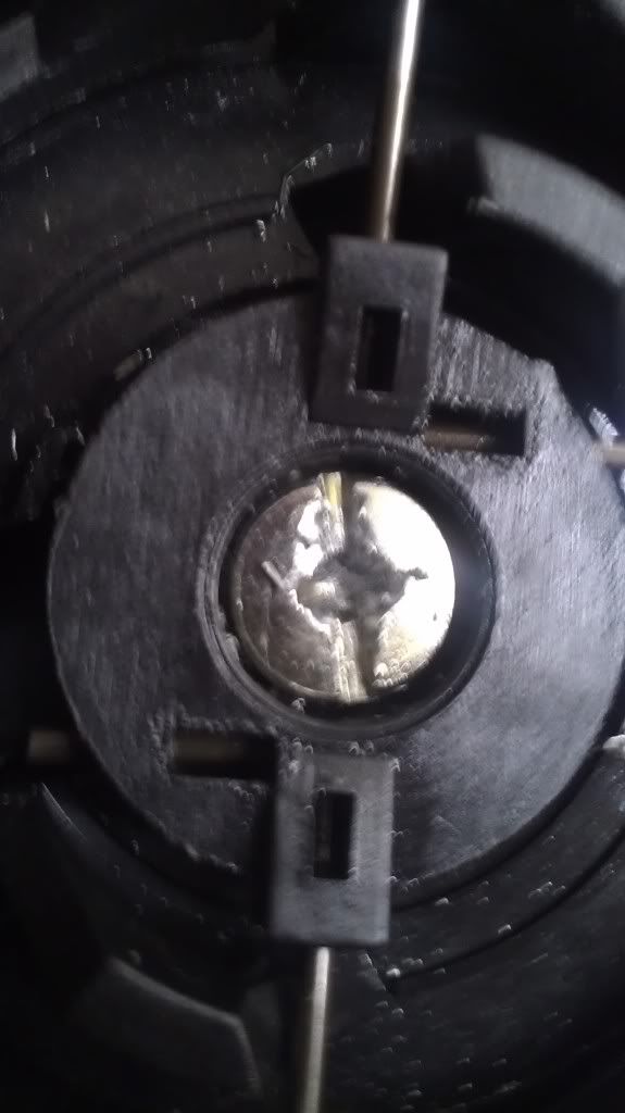

The bolt Isnt comin out! FML
just my luck! look at the screw, its super tight its not movin at all!!

i have to remove the screw pictured above but its not coming out -___- i might just get a charger and use the electric start
