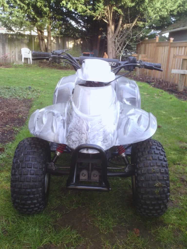

I've got an 50cc kids quad ( Eton replica)
its got an oil injector, but im not sure if I want to use it!
i don't know if it still works and dont want to find out if it doesn't.
the quad has a 70cc kit, ported exhaust, high performance exhaust, high performance pod air filter, high performance cdi, rejetted/ tuned carb, and that's about all thats done to the motor.

well i just finshed making the expansion chamber in the exhaust. put it all together and tested it out.
this thing now has a power band!
it revs up like normal, then it his this power band that is VERY distinctive! before I moved the pipe it would not scream like it does now! im getting 2-3000 extra rpm!
im SURE stock it would not have a powerband like this!
besides the expansion chamber the exhaust has 5 more holes drilled in the muffler and that helps a tun too!
