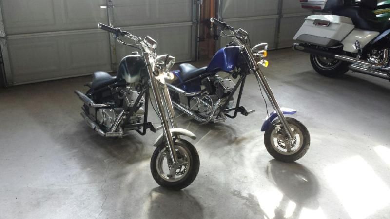

I've acquired 2 49cc mini choppers one runs good the other I'm getting frustrated with. I've replaced the carb, spark plug (BM6A), fuel lines and filter. I checked for spark and I'm getting a nice bright blue spark I also checked for compression on the cylinder and its got compression and it still wont start. Any advise would be appreciated I'm not sure on the brand name but here is a picture of them.

Try to start it a few times and pull the spark plug, is it wet??, what color is it. Then put a little gas down the plug hole, put it back and try to start it. On a 2 stroke, the plug can get fouled real easy.

The plug is wet. Seem to be clean. I put some gas down the chamber pulled it a few times and still wont start.

For the spark to be considered strong enough to fire the engine it must be able to jump a gap of atleast 4 times its specification from plug end to engine fin which is around .120"........A tester like this helps out heaps.............http://www.nationaltoolwarehouse.co...HqMVnKcd2NbW-G49AtGmktuI6b3dKm77Ud5cO-gvw_wcB....So does a dark room.
I have quite a few coils in a box gathered over the years that will give ya a descent shock but wont fire an engine and never will.........coils get weaker everytime you ground them out to kill the engine..
Sometimes the magnets and coil thong ends get rusted up and cause spark weakness and pulse interruptions also known as misfires........Make sure they arent rusted-up..If they are rusted remove the coil,,,de-rust both halves with sandpaper and reassemble with an airgap of .020" then retest.....Id also swap out the plug just for reassurance because quality control and pride in your job went out the window 8-9 years ago..........Good Luck

Good news: swapped the coils on the bike and the other one now works like charm. So I guess it was a bad coil that caused the no start issue.
