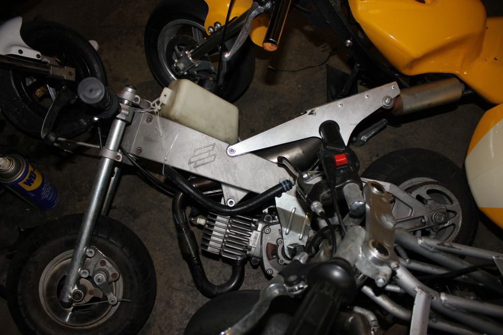

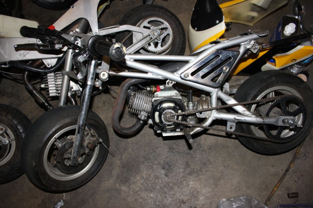

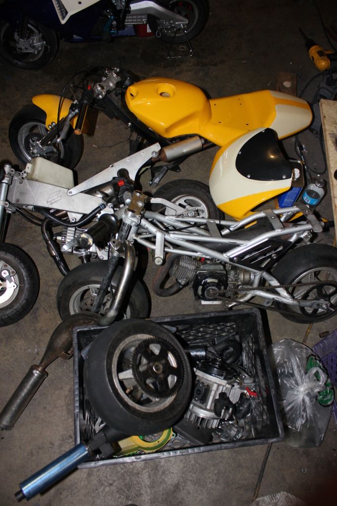

lol, I'm supposed to be selling my extra bike and what do I find myself doing??? Driving 40 minutes to pick up a 3 for 1 Special.. Almost dissapointed when I got there but after going over it all I think I faired pretty well... I got a Polini 911 Dreambike with Busted PullStart and no Seat Plastics plus 2 Cags. 1 full fairing with everything except hand grips and another I think it was a half fairing cag with no Fairings.. Plus a box of extras.. Well really just a HP carb, extra cylinder, piston, stock crank and extra Coil. Everything else was for the taken apart full fairing cag.. I got it all For 120 Bucks..

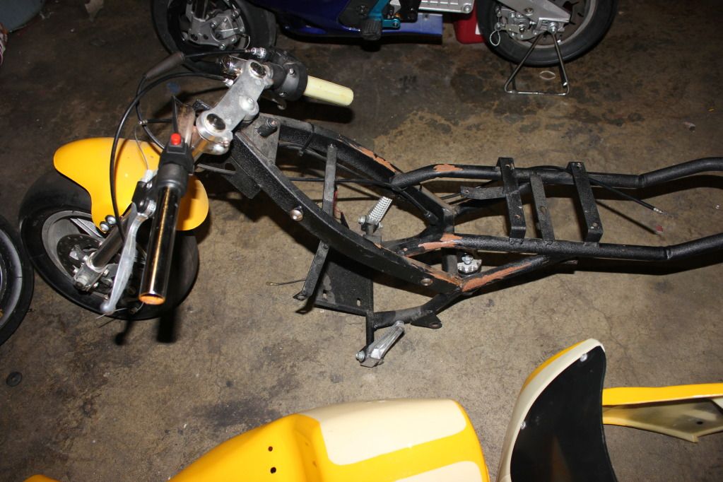

The Dreambike only has the 4.2 Polini Case but still stoked... I'll get it running and looking good and pawn it off to someone.. I started painted the Rusted DeathFrame and going to get one together tonight.. Think I found a buyer for it already...

Ya, only Series 1 but still happy... I got the one that was apart back together... The Pull start needed repair, it needed a chain, Hand Grips and the Needle was way too lean so it bogged out when the choke was off..
Oh and A bunch of screws and axel spacers were missing..
I can’t figure out how to get an Air filter on the carb.. There just isn’t enough room between the carb and swing arm.. I tried thinning out an air box as much as I could but it still wont fit..
Here are few crappy Pics... My friend came and picked up his good camera... So I guess I'm stuck with my phone camera... Guess I need to start saving for a new real camera... These pics suc

The Yellow one was has been sold.. got my money back, plus 80 bucks and the other two bikes (polini 910 w no gas tank or seat plastics and Cag w no platics or gas tank) for free..
Anyone near me have some Half Fairing Cag Plastics or a Polini 910 Gas tank and seat??? lol
I almost got the Polini Started.. Checked compression and there was only 40 PSI. I popped the head and there was no ring on the Piston.. Not too much damage to the piston only looks like the ring hit in one spot then maybe shot out the exhaust?! I cleaned the groove and made the ring I had for my other polini piston float nicely.. Got it back together and have 125- 135 PSI now.. I cleaned the 14/14 carb out and have a 68 Jet in it but it wont seem to start.. I have good spark and when I throw some carb cleaner in the carb it starts for a second or two and dies out like its flooding.. I cleaned and put on my other 14/14 carb and it started for about 20 seconds and died.. And the same thing is happening still with the new carb… Could my 68 jet be too Small/large I don’t have one smaller than 68.. I’ll try a 72 see if it starts but with compression could it be the Reeds? I didn’t check them out yet… The gas tank im using has clean gas and flows good… Oh the pocket bike fun…
Oh and.. Should I be running blue or Green Polini Reeds on my bikes? I have two green sets and one blue.. Should I put the blue on my GRC??
PBP SENIOR M!LKER
2,445 Posts
Discussion Starter · #14 ·
Hell ya! I was stoked with the deal! i didnt even try to talk the kid down.. It was all he was asking.. I got the Polini to Start and it sounds good!! The Piston was on backwards (Noticed Back Firing when I was trying to start it so I knew something was wrong) After I switched that I opened the Reed cage and it was on upside down... lol
