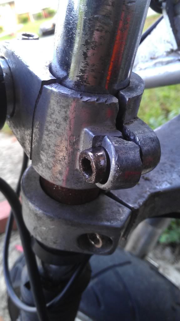

Broken tripple clamp? Don't know if you'd have to get a whole new one. Might be able to get away with it since there's a clamp right under it. Torque down all the other bolts real good.

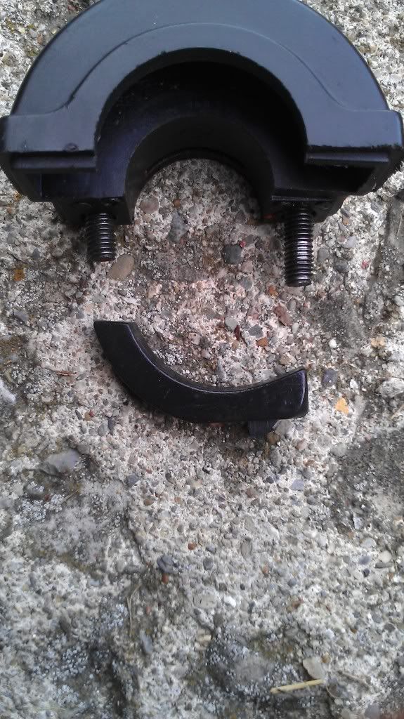

5 mins ago I was riding my bike like a dumb ***,my left clamp is broke but it gets stacked ate certain point in time so i thought it was nice and tight so I thought I could ride it , thank god I was only goin like 2mph up my drive way when my clamp snapped off completely but I escaped with minor scratches
Id ditch the crappy clamp ons and retrofit a set of Mountainbike handlebars......its easy to do and alot safer,,,,,,,,,,,,,,,,
It's super ugly, but I may do that while waiting for new forks etc
