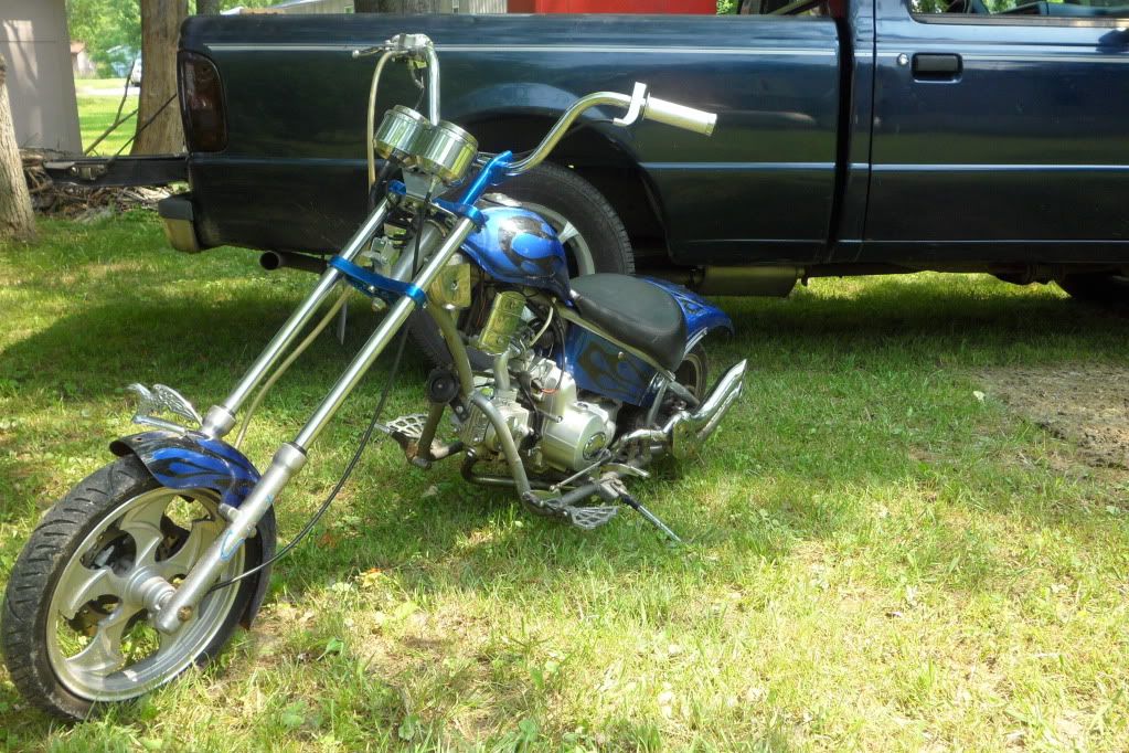

i need rear end parts like the shaft that the rear end pivits on and the sprocket that has barrings with 2 sprockets on it, it goes on that same shaft that runs through the pivit point on the rear end
what i know is the bike has 49cm3 stamped on the side of the head...
its a 4stroke
4 speed semiauto (no clutch)

I have the exact same bike. My rear axel bent and I had to replace it. the one that comes in it is soft and cheap and so are the replacements. I went to ace hardware and got a grade 10 hardened bolt. Its metric so theyll have to make it but it only took a day. I replaced it and I havent had any problems since. It handles the torque way better that the original.

btw I need a rear fender for mine. did you ever find someone that sold parts for this thing? Your serial number should be a FS-516 manufactured from the buyang group. Hope that helps.
