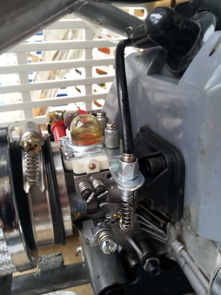

okay so i recently purchased this carb http://www.amazon.com/47cc-49cc-Poc...UTF8&qid=1344554906&sr=8-3&keywords=47cc+carb for my 47cc cag and it seems like the throttle cable is a tiny bit too short. Does anyone else here with a cag have this carb? Am I doing something wrong?

Mind taking a picture of where your throttle hooks to the little screw? it'll help out tremendously. How much is it too short?

Does this help? The cable is a bit too short.
If you get everything tight it looks like it might work. Loosen or tighten the hand nut on the throttle on the hanle bars (which ever lengthens the cable) and make sure each end is sitting in the groove, and try again..
If not try what EPR suggested, but if its not necessary you dont gotta.
Good luck my friend
Take the throttle cable off the handle grip end, put the other end on the carb piston, then hook the cable back to the throttle and see if it's too short.
Good luck my friend
I loosened the nut, i tightened it, i even tried taking it off. Still too short.
Tried it, didnt work
Also, is it normal that i should have to loop the cable around like this?
No, that is not normal
Well than what the hell is wrong lol because if I don't do that, the throttle cable just slips out
Once hooked to the carb it should not slide out.
There should also be what i call the 'support' bar..
Which is wht the cable slides into and its the stopping point.
I will demonstrate
now i had to cut my spring and i also had to flip my support bar around. Ill demonstrate that on my build thread and link you
How come ur carb is upside down?
Is it supposed to be mounted like that
Yessir, I'm almost 100% certain that the walbro pumpers are supposed to be mounted pumper right side up
Ooh ok ,I was just makin sure I'm used to the stock carbs Lol
