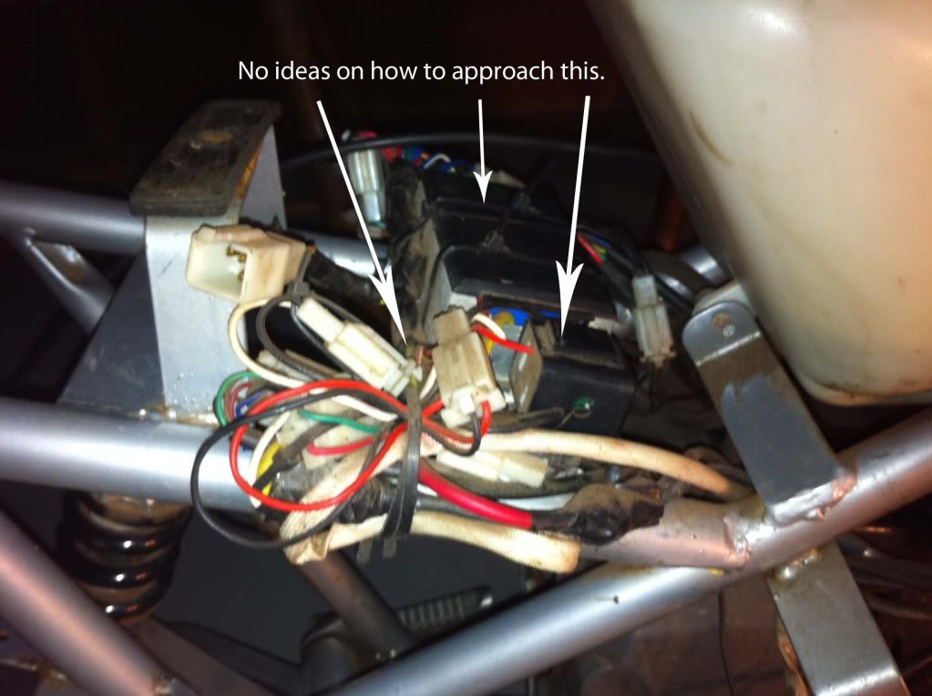

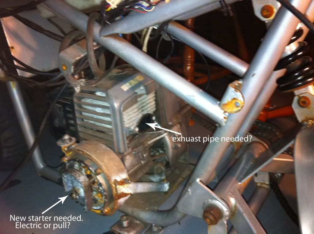

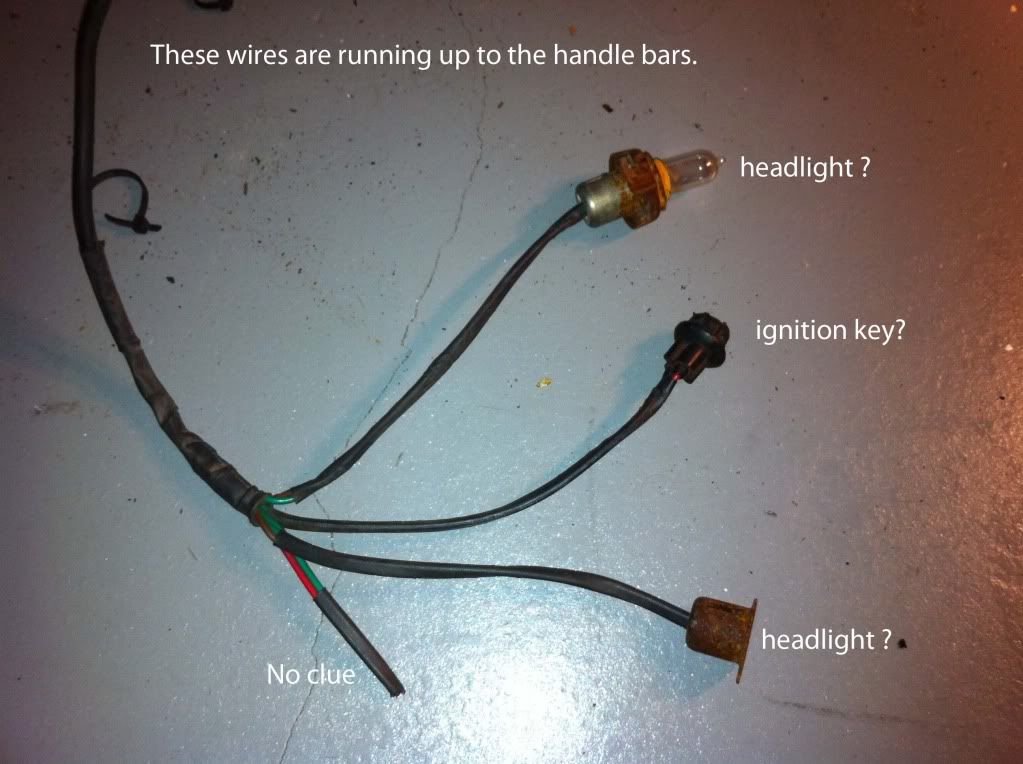

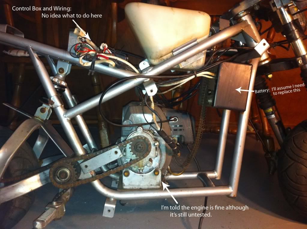

Hey everyone. I'm new to this site and I apologize if this is the wrong place to post my questions. I recently bought what I think is a Cat Eye pocket bike from a garage sale for next to nothing. I was told the engine works fine but it obviously need some other work done. I have absolutly no experience with pocket bikes at all. It was just kinda of an impluse buy and I'd like to get it up and running and have some fun.
I'm not looking to do any unnecessary mods or even to restore it to it original condition. I really just want to simplify everything and get it running. I dont need to have headlights, tail lights etc. I know for a fact that the starter needs to be replaced. I'm not sure if it is originally wired for an electric starter, that would be nice, but a pull start would work fine as well. I took off the plastic housing and some photos with notes on them. Hopfully I can get some insight on how to fix this thing cheap and effectively. Thanks in advance.

Seeings your bike is a lil beat up and most of the parts are either busted and such i would go with the easier fix for the time being just to get it running first......To do that you need to do the following.............
remove the e-starter http://www.pocketbikeplanet.com/showthread.php?t=58861
remove the battery and all the wiring...........its not really needed
get a gs moon pullstarter and starter pawl
get a stock exhaust box or performance rev pipe exhaust
remove the transmission and service the clutches aswell as check the flywheel /pickup coil for rust,,clean them up and gap to .020"
The engine will fire up just like a weedeater and doesnt need the wiring to run.......The battery / switches and wiring are for the e-starter system aswell as gauges and lighting and are more trouble than they are worth....Good Luck

Thanks for the tips. The e-starter removal guide seem pretty clear. although i have no idea how to: remove the transmission and service the clutches aswell as check the flywheel /pickup coil for rust,,clean them up and gap to .020". Like I said, I have no experience when it comes to this stuff. So all of the wiring can go? even wires attached to the engine?

The two wires coming from the engine case can be hooked into the wires coming from the starter pushbutton to make a killswitch out of it.................
The transmission is on the rightside of the engine and the best way to remove it at times is to remove the engine totally but can be done with the engine attached also.......Its also good to take 100 grit sandpaper and deglaze the clutchpads and clutchbell
Any rust any oxidation should be cleaned off.............The right side has been cleaned and lightly polished to prevent re-oxidation that causes clutchpad sticking
Back together all modded
It would also be a good time to mod the flywheel aswell as throwing in a rocket key..............I clipped 3/8" off the tips of mine with a hacksaw and a hand file..........

I (like lots of others) pulled the battery and almost all the electrical off of the bike, we race in parking lots, the thing is never gonna be street legal, the lights are a joke (really dim) !!!
Plus, Imagine how much easier the bike is to work on when it's all mechanical, and the only electrical is the kill switch and the coil / spark plug!!!!

Anyways, just to clarify the work to be done in the next few days:
1) Strip the bike of all wiring (control box, battery) with the exception of the two wires coming out from the engine that need to be connected to kill switch.
2) Remove electric starter
3)remove and clean tranny/clutch and install rocket key (what does the rocket key do exactly?)
