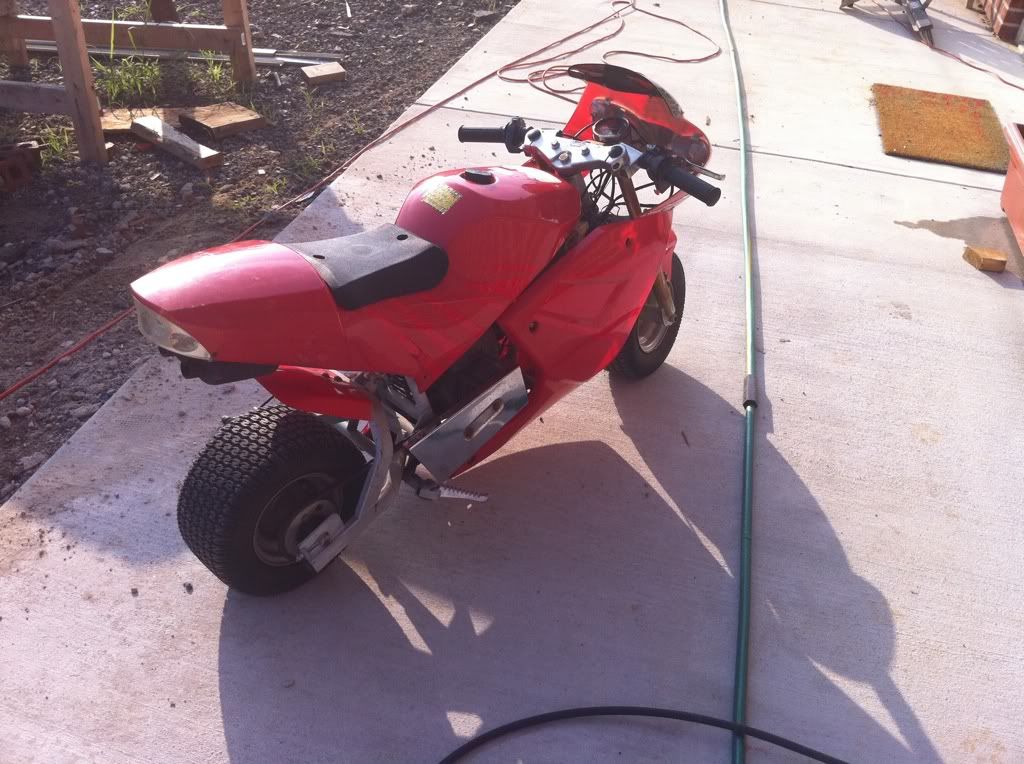

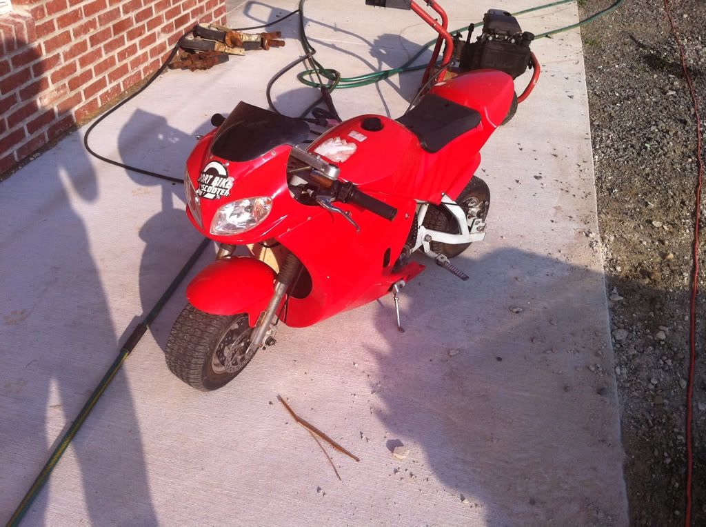

hey guys im new to the pocket bike world and was just wondering if yall could tell me a lil about what i have cuz all i know is its 50cc lol.. here she is..
i have another just like it but its silver and @ a buddies house. if yall could tell me what kind of bike it is i can start modding the hell out of it.. thx

Not a 50cc .... 49cc. your bike is called a Cateye. If you take a look in the Midbikes section of the forums, there's hundreds of threads about what can be done to them.
Welcome to the forums .. you got a nice ride there.

Welcome to the forum and good luck with your cateye...........
Sooner than later youll be back asking on how to make it faster........
Almost anything you can do to an X1 engine mods-wise you can do to mod a Cateye..............
Basics are......
hp carb...I mod the stocker 15mm to perform like a hp carb
velocity stack
lightened flywheel
lightened clutch
boost bottles
rocket key
fatty or rev pipe
NGK sparkplug BPM6A gapped to .030"
remove the e-starter to increase revs and ease startup.....
smaller rear sprocket
