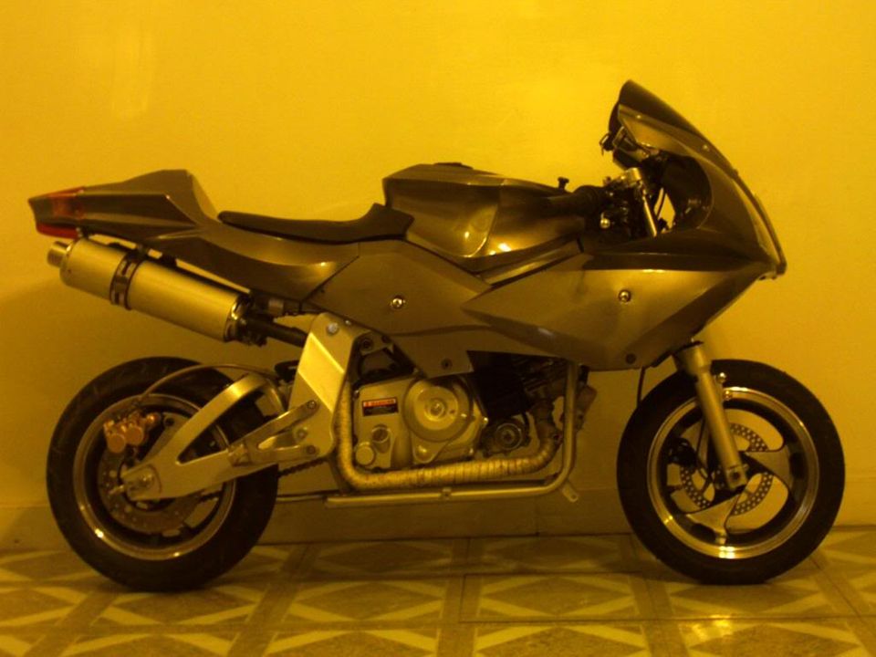

If you look at my X18 it has a $190 steel alum side pipe with an all alum glass pack from an X12. Before that on the stock muffler I drilled little holes around the back inner pipe then ripped it out and cleaned it up. I had this very long 1/4" drill bit, that reached the middle baffle and drilled holes all over it, Made a big difference in sound, and help performance a little too. I have a 14th/15mm front sprocket and alum PBU 28 tooth on the rear. I put a 25mm dirt bike carb on 24mm modded alum intake manifold on top an alum carb swivel.

You have to do it on your own...………….They've never made an extended swingarm for an X22..Theres reasons why too...The frame isn't the strongest to add all that extra fulcrum length to and the design of the frame isn't too appealing as it looks like a Toys R Us bike and that was supposed to be the ultimate model back in 2007..Lots of hype....What sux is you cant even turn them into racing bikes either...…Theres a member that tried and almost killed himself and almost went into the spectators at the track too trying ......LOL
The most successful thing he did was mount the X15 bodykit on the X22 which wasn't hard at all seeings the bodys share similar traits like the gastank
The footpeg are bolted to a flimsy piece of c channel steel that's only screwed to nutserts that are tack welded to the frame...
Seeings the rear shock doesn't ride up n down on an angle like a conventional pocketbike youre gonna have to do some hefty research finding one skinny enough at the frame and wide enough at the rear tire with proper shock mount to get it done...
You may be able to get away with the cheesy streetbike axle extenders that extend the axle mounting back 1-2"
Off the top of my head you should look into a PW80 rear swingarm for a starter...……It has the right shock mount you need...
