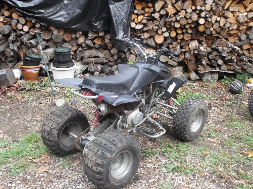

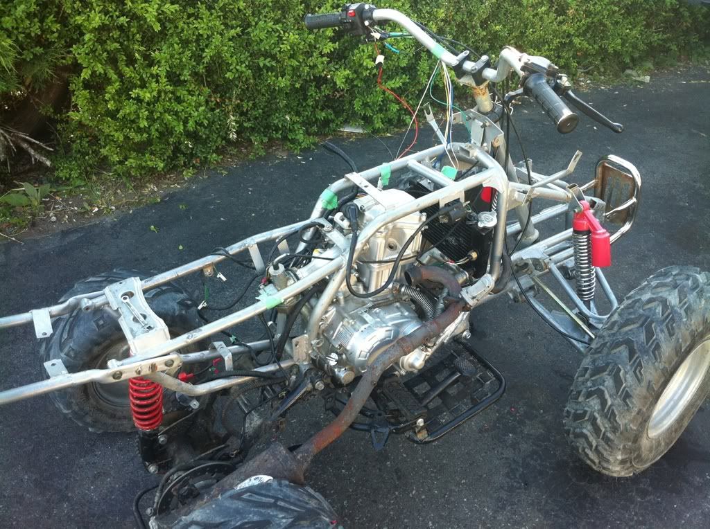

My quad is a 200cc Zongshen that has a clone engine from a 70's Honda bike as far as I know. Still sorting out the wiring on it and so far have gotten it turning over but still haven't gotten spark. I've decided to use the 26mm Mikuni that I ordered for my gf's loncin on this once it's ready.

I have a similar quad to what you are talking about with no spark. Try the obvious - kill switch & ignition switch work right. All components needing grounds are gounded. Coil wiring looks good. S/plug is good & plugged in right. Try unsnapping plugs & reconnecting 1 @ a time. I did find a broken wire inside the insulation just past plug going to stator. You can feel along wiring for a soft spot to find a break - unless it is totally dislodged. A good idea is to Dielectric grease connectors before it sees any water once the repairs are done.

The wiring was all disconnected when I got it and it's missing a few pieces, we've got power all the way to the plug now on a tester, something's still off though as we're not getting spark
