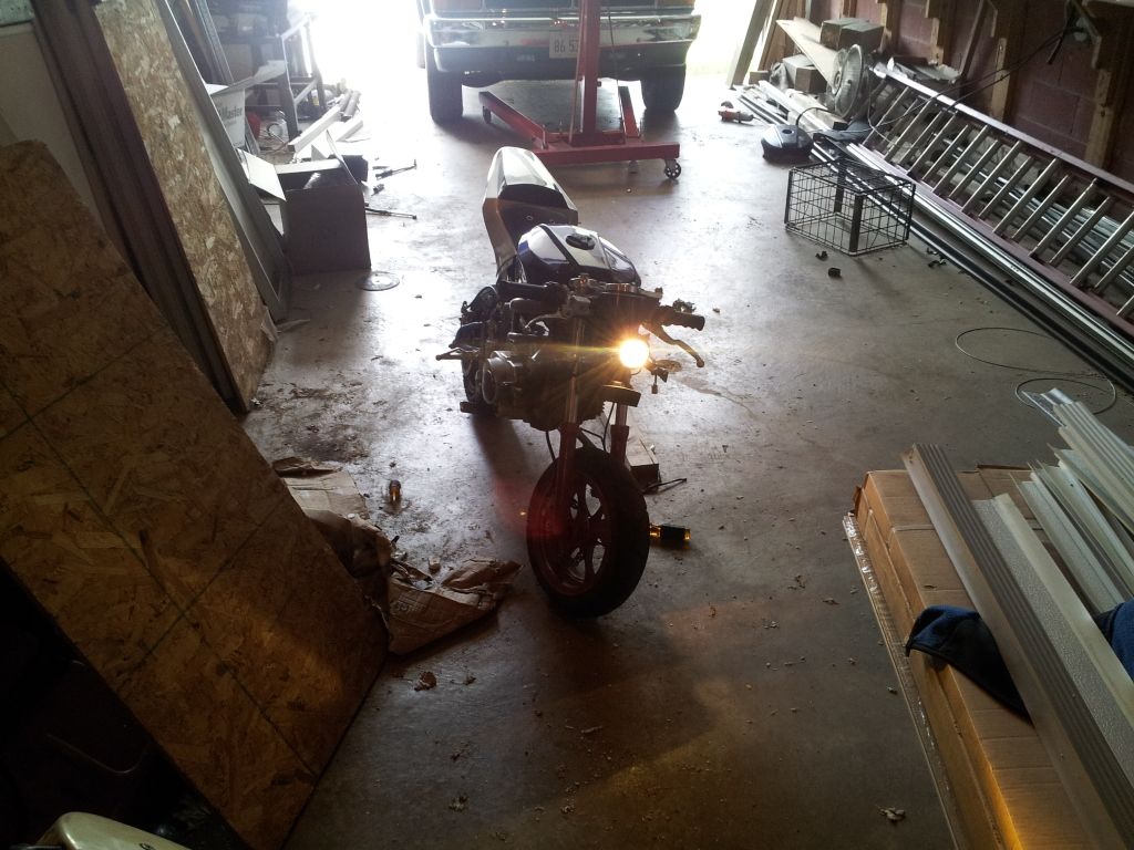

as for the body work, i really like that look....LOL heres what mine looks like right now......its close but not quite...
i love the blue tank i picked up.......shoot i may be able to pull off the street fighter look with just some well trimmed plexyglass... and painted....
