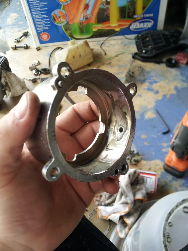

Also, I noticed something odd when pulling apart my starter housing. 3 out of the 4 housing bolts are the same length, but the top part on the 4th is slightly shorter which seems to me it was cut off... To fix, I simply offset it with a couple of washers, but i definitely thought it was weird. Ill post a picture to demonstrate.
The left is the shorter of the two, with a gap at the bottom, however that was as far as it went in..

On ur second pic from the top, what is that starter catch used for?
The pull start attaches to that housing, which turns over the engine
