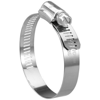

ill go to harbor freight and pick up some of those hose clamps you screw tight to hold the wrap on near the exhaust manifold and the back near the muffler. they would work good to hold it?
http://contentinfo.autozone.com/znetcs/product-info/en/US/rdy/KE36SS/image/4/
The wrap you picked is good....at the autoparts store on the HELP aisle they have stainless ty-wire.....Use that,,,,,
