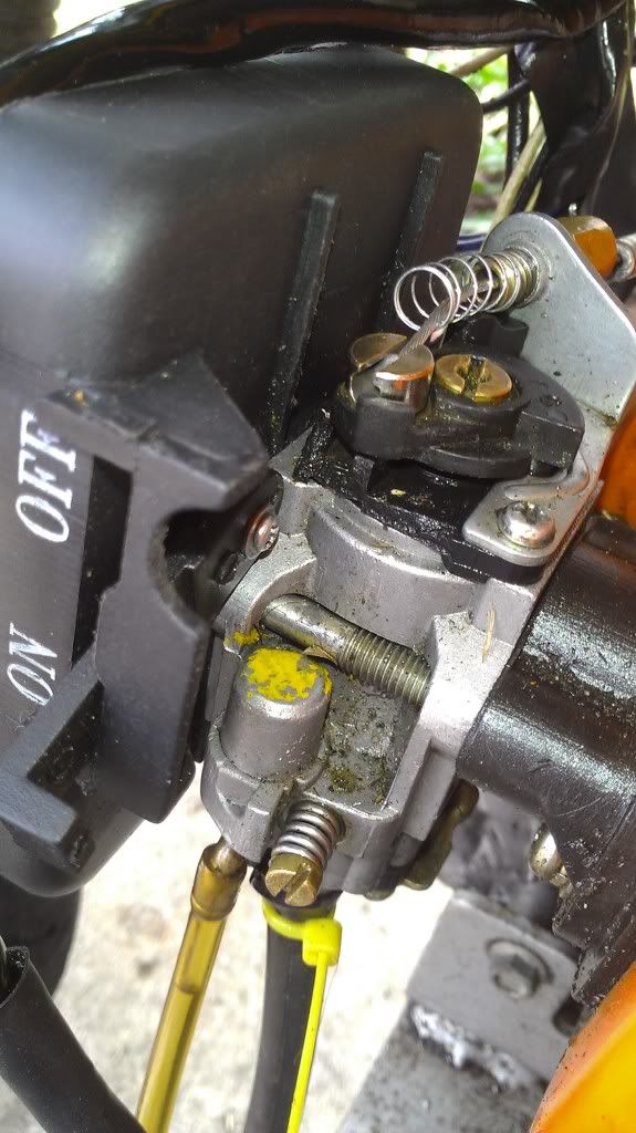

when i start my bike(choke lever on "ON") the bike runs and doesnt go passed 3mph and when i start the bike with the choke lever on "OFF" it will run for about 30 seconds and die, if i use the throttle it does nothing please help im really irritated sorry for tripple posting:mad:.
this is what my throttle cable(on the carb) hook up looks like, maybe i connected it wrong?sometimes it pops out if i move the throttle all the way up(not reving)
the bike when i start it on the "ON" position i think(this isnt me starting the bike, i know my friend started it wrong)sometimes im able to ride it for like 15 seconds at 3mph then it turns off and this happens plzzz help!!!:

You have no idle screw on top the carb to hold the piston w/ the hole in it open so it can run. It has broken off the black plastic piece on top the carb.
See if you can see it in this photo. Need new $15 carb.

The piston has a hole in the middle & a spring, it stays closed, the screw rides and the plastic cam at the top and opens it as you screw it in till you get a good idle. There's a low jet adj ontop the brass piece and the spring loaded screw on the side is the high speed adj jet

Your missing the idle adjustment screw. It adjusts the rpm of the engine at idle.
Looks like you have a hint of green in the hole on top of the carburetor. If you do the main jet is not adjustable on that carburetor and you will definitely want to replace it. This carburetor never functioned well in most cases.
