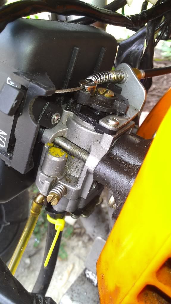

okay so i got it started but yet it wont go past 3mph even if im off of it, and i think a parts broken look at the pics
It looks broken to me nand seems you missed getting the cable into the larger end of the trunion..the carb rotator needs to be set wide open to allow the leaded end to slip into the hole...the little ledge keeps the cable safely attached within the trunion......Open up the throtttle housing up and see if the cable is indeed broken....If so theyre $8bucks shipped on ebay...

Can someone post a clear pic of were the throttle cable is supposed to go?(into the carb) please
My cable slides out every time I use the throttle ,i think I'm gonna buy a new carb because I haven't seen that part for sale(were the throttle goes on the carb)
can you tell the diference between the small and large end of the cable end trunion?...If so like I stated you need to rotate the trunion til the leaded end fits into the large end of the trunion......Theres a small lip that hinders the cable from going in and coming out if the rotator if it isnt flipped to wide open mode to feed the cable into the trunion with trunion oriented the right way............Good luck........
\Heres how youre most likely trying to hook it up.............This is the wrong way
You must turn the cable like this..notice the cable safety step lip catches the cable.......
rotate a lil more and the cable will pop into the larger end of the trunion when the cable is fed through..............
dont forget you need the pusher spring..............you may need to pry the trunioin channel open a lil bit or may have to file down the lead end a lil bitn to get the cable to fit
Ohhhh I think I know wat I did wrong, I didn't have rotator wide open .i can tell your rotator is more to the right.I will try this tomorrow thanks
