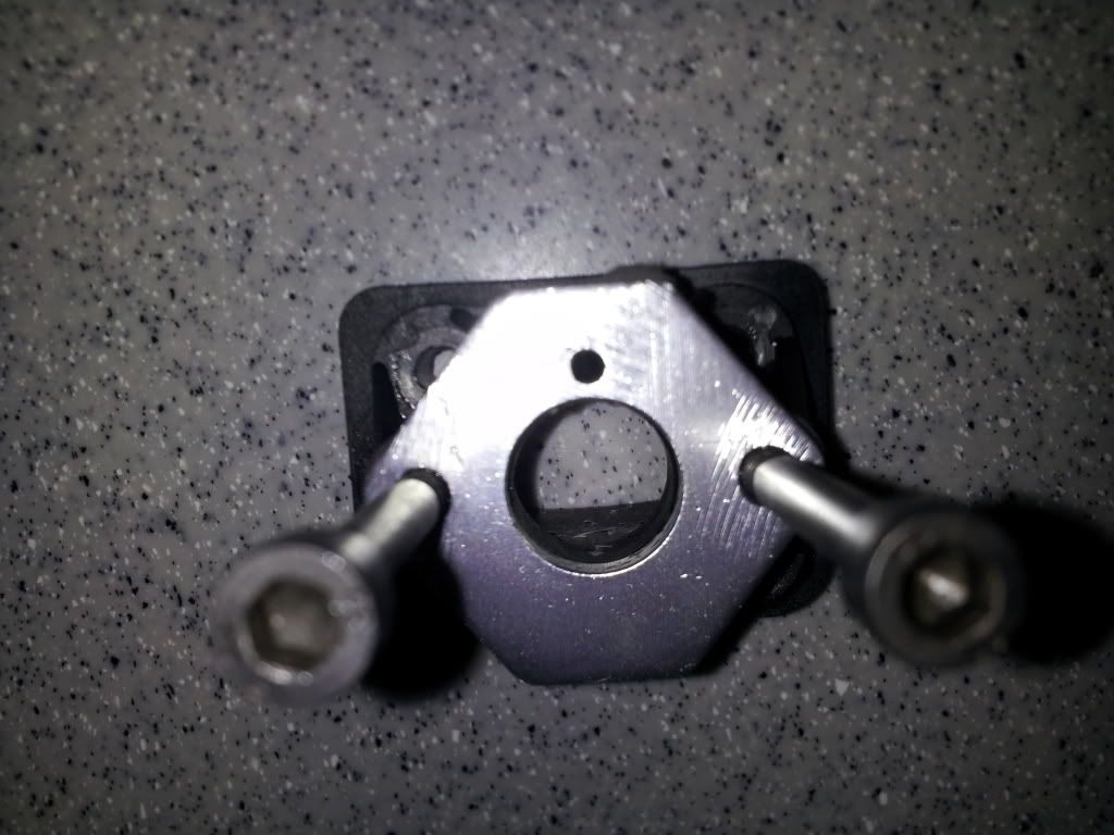

I also took the carb back off to inspect what i call the vacuum hole. It didnt line up for SH!T, and i was naive for thinking it did. To correct this, I put the alum plate on, put the bolts in to keep the plate squared away, and i took my drill with a 1/16 or smaller bit (I forget which) and started a slight hole down, then free handed a taper towards the bottom hole. Worked out pretty nicely and i didnt check, but i do not believe i have a carb leak whatsoever.
Heres what the manifold looks like now
And holding it up to the light
Took the drill to it some more after this picture so its a clear little hole, no black.

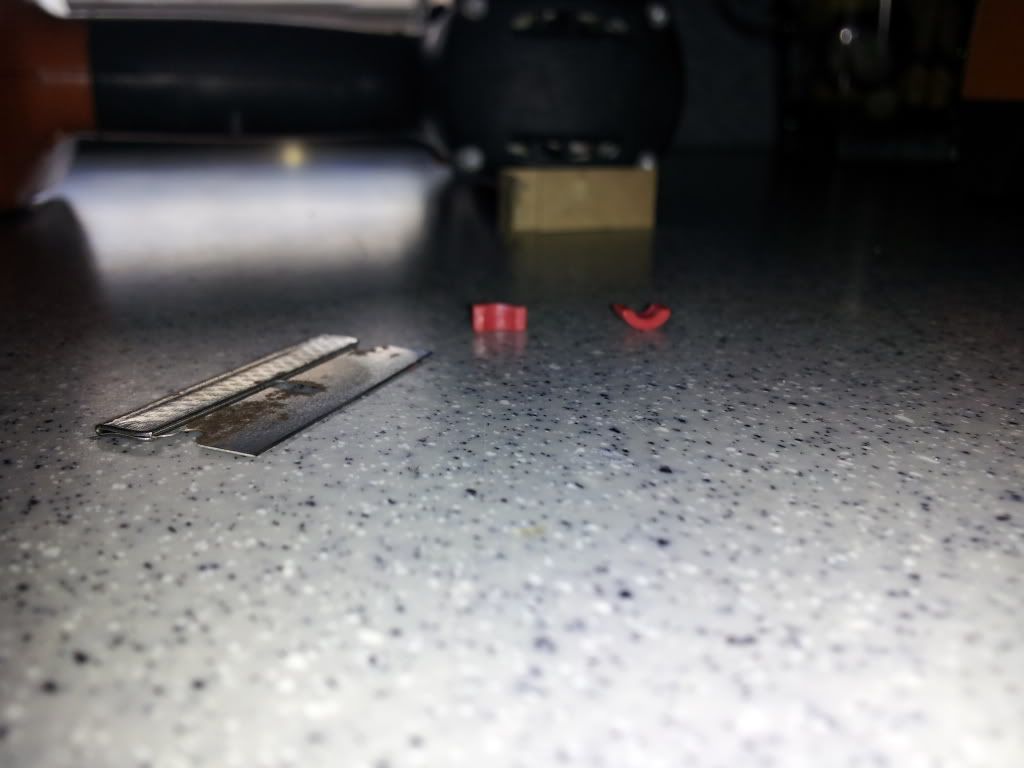

Next on my agenda was to fix the choke lever, because i was scared the carb wouldnt seal against the manifold correctly.
And now, ALOT more clearance

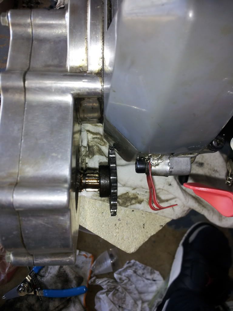

Then, I was like cool, everything is going as smooth as butter, lets change that sprocket up front while the engine is out, so i dont gotta bang up my fingers later..
Yeah, these cvts are so tiny, that the stock sprocket doesnt come off with the cvt attached to the crank.
Disassembled the trans from the engine, used one of those c clamp tools (makes life EASSYYYY) took of the sprocket, which came off nice and easy (should have been a warning for what was next)
I went to put on the new sprocket, which must have been machined poorly or just for the wrong gearing, but it didnt want to go on.
Not taking no for an answer, I decided to help it a little bit and ended up with a chipped sprocket and one that was stuck on and wasnt budging.
This is where i panicked and started to get extremely frustrated, but where theres a will, theres a way, and i managed to get it off..

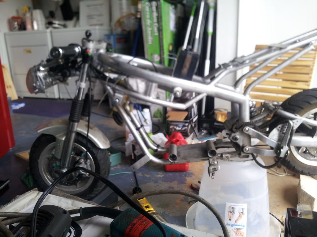

COOL! So whats next.. the exhaust? yeah thats all thats left pretty much, so i went to tackle that..
The pipe was welded so poorly that the welds were getting in the way of my bolts, not to mention i was shipped the wrong bolts ( said online that its manufactured for the x7, which i have)
My stock ones were meant to be used with an intake manifold, therefore were longer, so i headed off to home depot and grabbed a couple that should work.. This is actually where I ran into the bolt not fitting problem.. (Sorry was so frustrated at this point i didnt snap any pics)
So i gave up for the night and bolted my stock back on with a new gasket and a manifold.

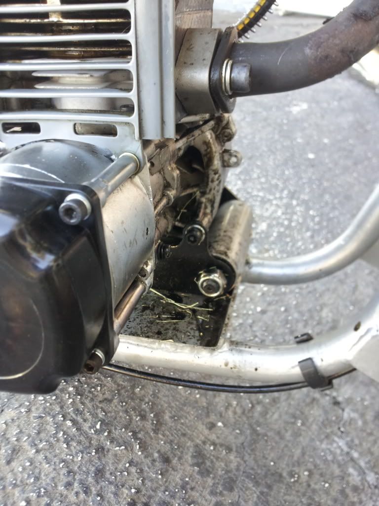

This is where i noticed my exhaust leak, and to my eyes a moderately-severe one lol
^^^^^ This was JUST cleaned with simple green, so yes its new lol.. Not sure how to stop it, but i need to mod my fatty pipe, the stock one is torn to pieces by the previous owner.
