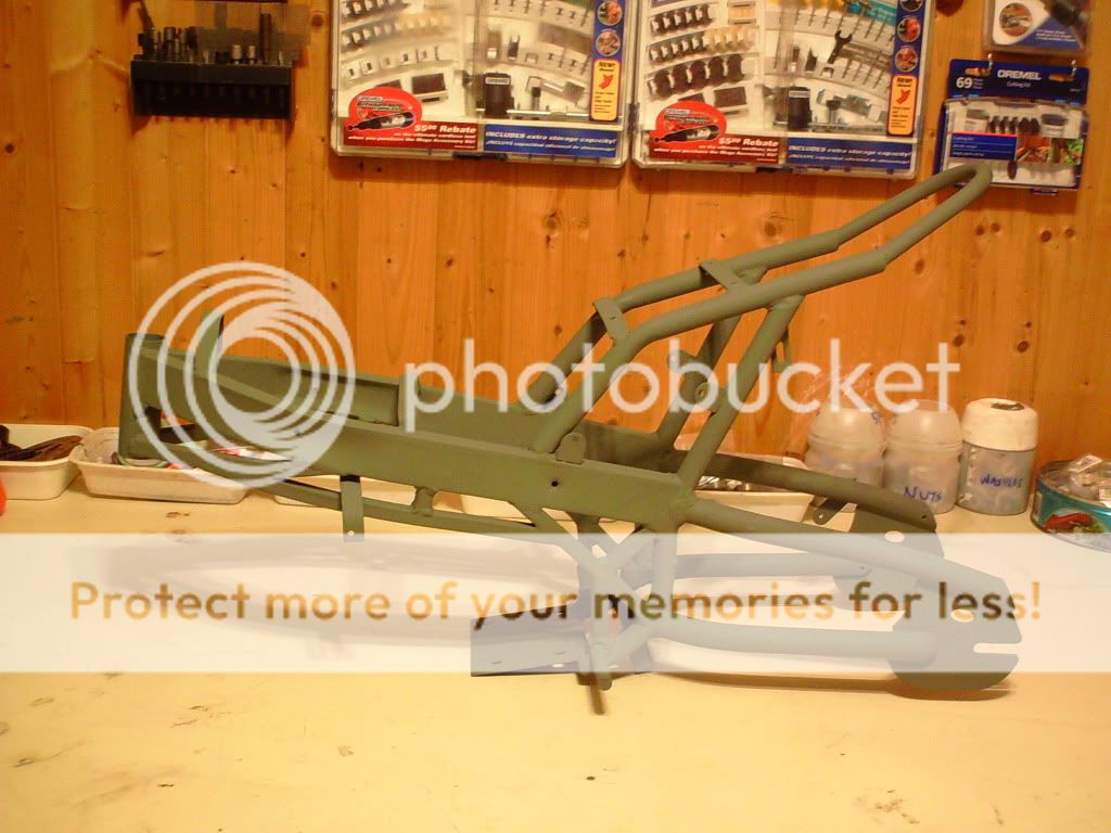

Just a quick sketch-up of what I have in mind. The darker area is 18" sheet aluminum as a seat support. Although, it could be done in 3/4" steel tube. The main frame spars (from the steering head to the rear axle) are left over 1.5" seamless, .095 wall, rollcage steel (as per SCCA spec). These would be strong enough all by themselves. The extra 3/4" tubing underneath is for engine and peg mounting. I figured since it's needed for that, I might as well try too get some more structural rigidity. The bodywork is just something I threw on there.
I do have another idea where the rear end is like a swingarm but no suspension. In the place of a shock would be a rigid, adjustable length linkage, to set the rear ride height and thus, the steering head angle.
Remember, this is just a quick sketch just off the top of my head and not even to scale.
