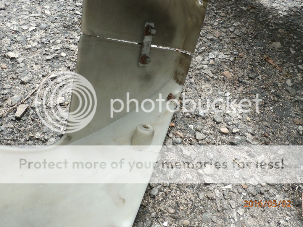

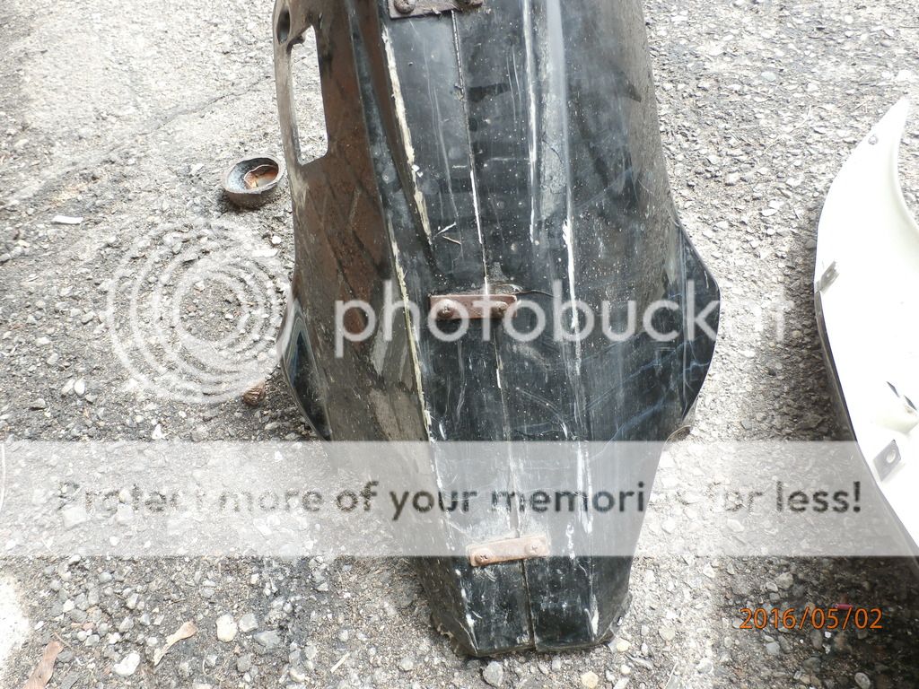

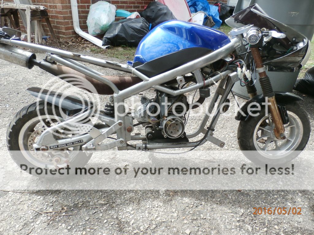

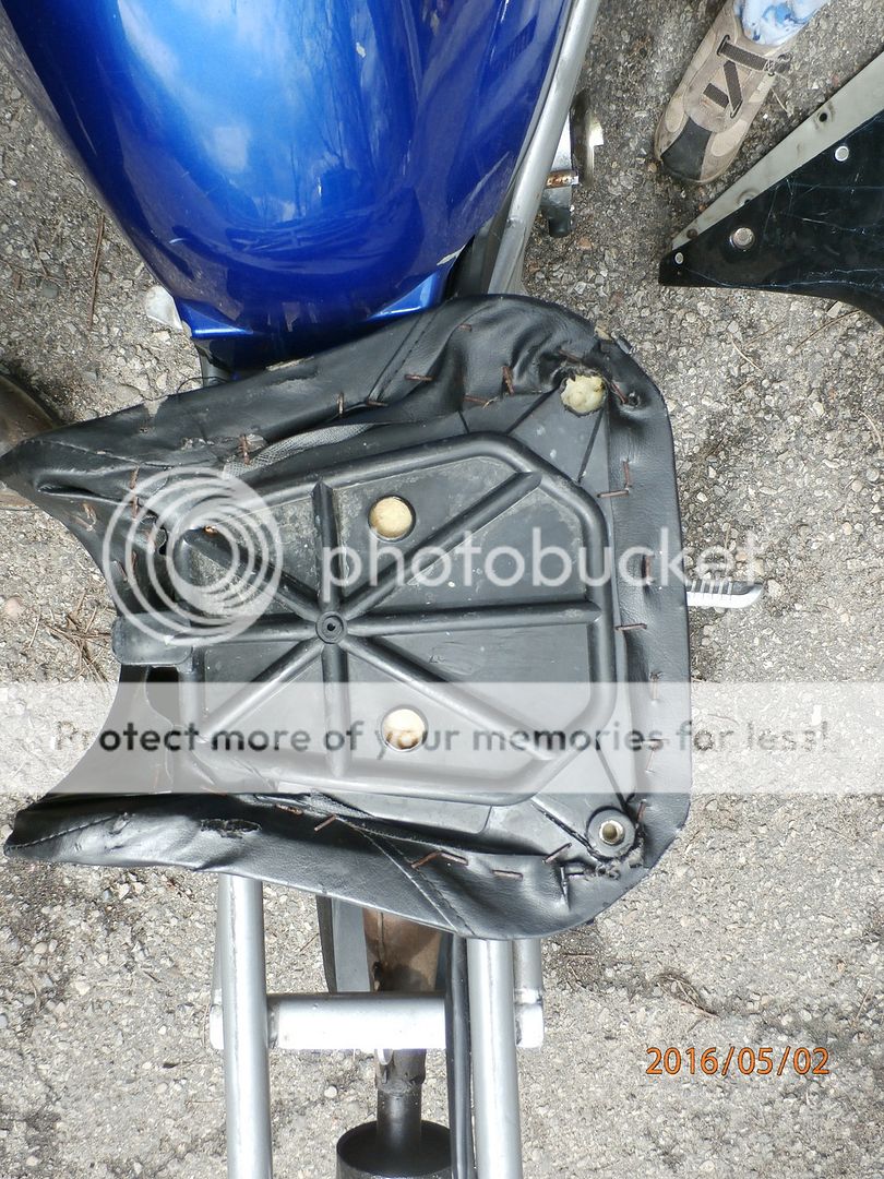

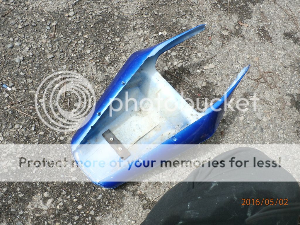

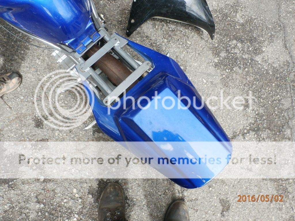

Well here's some pics with the plastics off. Shocks are rusted, gotta go get a pull start for it .. Air cleaner is missing . still haven't gone over it real careful. Going to drain the gas out of the tank today and maybe pull the motor off and see how much of the crud i can clear off the frame and probably blast and repaint it .
#9 ·
Permatex makes a 2 part plastic epoxy repair, or JB Weld and some material to go over the cracks w/ the epoxy to brace it. Fix the seat. Some people have used fiberglass and resin but that get expensive.
We all remove the stock air cleaner and get a 15mm x 44mm OD alum V-stack and 44mm ID w/ choke arm and a cone or foam filter. The gold headed engine above has that V-stack and choke arm.

the only useable mount points on the tail are the center points at the rear.. so I may need to weld some extra tabs on or something. I think I have an idea for the seat. at least for temp purposes. I'll probably end up with new replacement parts by the time the kid is big enough to graduate to it, Filed dispute on the bike i ordered so hopefully get my money back soon.. and just settle on the walmart bike to start him with
